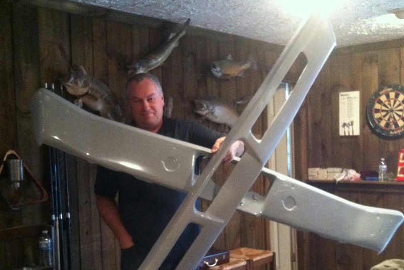

The diet on the GTX continues. Front and rear bumpers came in yesterday. I'll be getting my roll bar soon so I'll be adding more weight back. With what I've taken out and what's going back in, I'll still be down on weight and up a bit in power. Also the chassis will be much stiffer.

I see fish on your wall, does this mean you tend to fudge your stories a bit?:icon_winkle: Nice score on the bumpers, a little silver paint and mount (not on the wall either). I also made my brackets out of alum when i did mine for more weight savings!
Those fish were telling human stories, so I killed them. I'm having aluminum brackets made as well.
I like the reverse light recess, my old ones didn't have that. I have seen on Overhaulin they can spray paint to look like chrome. I think a black base and silver top coat?
I don't like the light recesses. I may cover them.

what brand of bumpers they are ??
how much ??
how quick did you get them ??,
how much ??

He got the AAR/Stinger fiberglass bumpers and he got them pretty quickly.
He told me he wasn't thrilled with the quality finish but he might have had a few :VB toast:when he told me.
They took less than a week to get. They were 169.00 each plus 50 bucks shipping for the both of them. Gel coat looked thin, flaking off in a couple spots and some "casting flash" on the front bumper that needs sanded. Not bad though.
