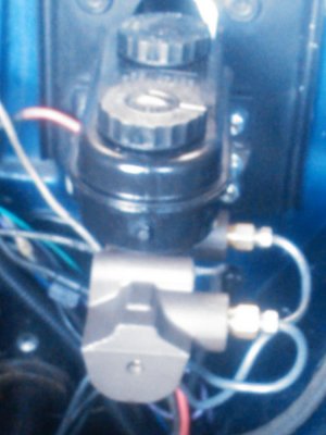

Just finished Installing this but it's going to have to wait till tomorrow to get bled.
