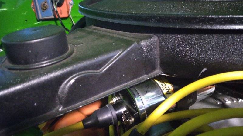

I can't find anything specific on this. I have Ma's electronic ignition on the 71 with a bone stock B motor (77 400 4bbl), single ballast (.8ohm and a 1.4 on hand), stock elec.distributor, 4 pin orange box and a 8140C coil. What is the correct resistor for this coil?? I was initially under the impression you could run straight 12V to it considering its a 12V unit but, it seems otherwise. I just have found nothing that specifies what ohm resistor should be ran. Appreciate any help
So can I run it straight 12v because of that 1.4 or do I need a 1.4 BR to match? That's part of my confusion....(it does say for points and elec. ignition)

A chrome coil is a veeeeeeeeeeeeeeery bad idea. Coil efficiency drops when it gets hot. One of the few stupid things Mopar did was to mount the coil on a hot engine, where it cooks.
Chrome keeps the heat IN, making the coil even hotter & further reducing the spark energy.

Appreciate it.....instructions are silly at best.. leaves one with more?'s. But it was a brand new coil and was given to me so I ran with it is all! I do notice as things get hot it runs shittier. Maybe Ill just run up and grab a in stock Master Pro 2 5195 stock replacement and matching ballast and be done with it for now
Try mounting the coil on the f/wall or fender, even temporarily to see if helps. Longer wire will not cause a problem.
