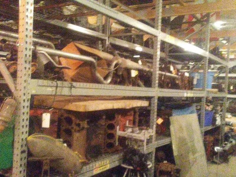

What would you pay for this 440 & parts?
Measure or get the block measured. Get it magged if standard and same for the heads. Lots of pieces to sell off for some dough. Me personally, I wouldn't use the reciprocating items. Boot them for a stroker. If the block is more than 30 over, the price dwindles quickly.
This is exactly what I am thinking. It sounds like a good idea in theory. Especially if the block is the standard bore size.
Look for stock motor. That way it dose not need to be bored too far. Went 20 over on a stock 383 to clean it up. Paid 400 plus shipping 150. My crank had one bearing race in bad shape. Motor guy said they rode the clutch. So had to find another one. Adding that 10 thou. over on the crank. All being said got almost 6 grand in the motor. New connecting road-valves and seat's. New cam. Lifters- push rods-Piston's. Ring set. It went on and on. So when getting part's like old with out having someone magnaflux the block and head's. You are looking at a risky buy.
I completely understand what you are saying. I think it would be very important for me to measure the block before doing anything to prevent a money pit from excess machining costs. Thanks for the comment!

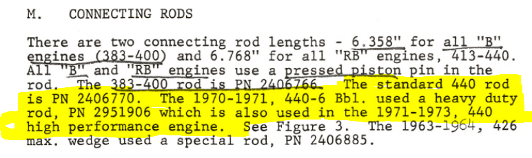

I do not know about big beam rods and matching balancer. Are those items special?
You will need the matching balancer for the crank if it is cast and not forged. The yellow highlighted explains the HD rods (big beam).....
And nobody wants them... They are heavier than an LY rod but not any stronger than an LY rod where it matters... Same small rod bolts, no extra beef around the big end... Just extra steel in the beam which isn't the weak spot...

I get what you’re saying. Worst case scenario would be scrapping the items that nobody seems to want. The block and 727 are definitely items that can be used at the very least I’d say without having looked at them in person yet.
I agree. The 6 pac rod is heavier but not really any stronger. That has been the word for 3 decades.
Thanks for the explanation you guys. I did not know this. So LY rods would be the ones to get?

They look skinny enough to be LYs .
The balancer looks right for the crank.
Pics just not quite good enough to say 100%
Good observations. I have to agree that the pictures are not the greatest. The seller probably did his best to fit them all in the picture. Lol
