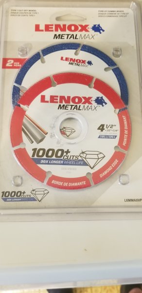

Actually, this package was unopened and the label says 'made in USA'. It probably came from an estate sale when I was working those. We did one north of Houston that belonged to a midget dirt racer and I tucked away quite a bit of stuff he had for myself before we opened the doors. He also had two cars....one that was apart and one that was complete. Got to be a small guy to fit one of those things! He was pretty little based on his shoe size of 7 1/2.

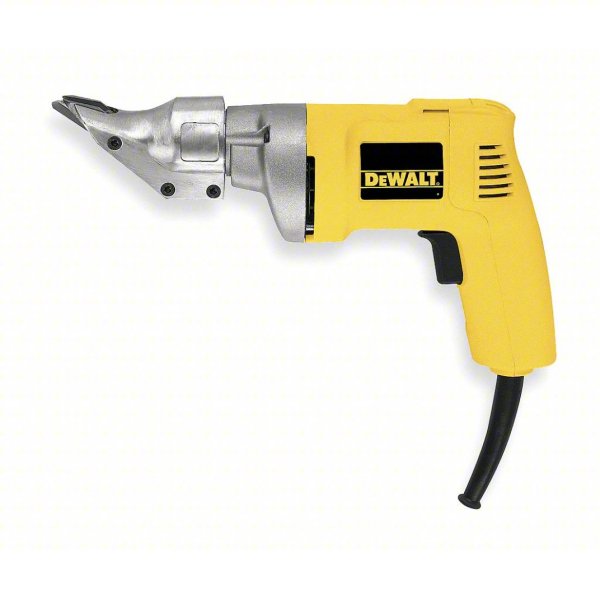

I used to install metal siding/roofing and these were awesome for ripping 40 foot long sheets. Would this be an option?
https://www.grainger.com/product/4L...Vh8_ICh18mQ39EAQYECABEgLFgvD_BwE&gclsrc=aw.ds
Guess I wasn’t clear :lol: How would they do on a quarter panel or roof?
I have an air powered one from 40 years ago, the hose makes it difficult.......
when I worked at a conversion van shop, I used an electric set often. I was in charge of installing the bay windows and the roofs......those shears were great for all of that...... you had to power through the blobs of attaching foam (left over after removing the support beams)

I got 5 packs of these at Tractor Supply a year ago, they were in the clearance section. Cut forever.
Lenox makes some good stuff. Not all of it, but some things they make are top shelf. I like their coated edge utility knife blades also. You CAN NOT get them to break, which means they are 10000% safer than any bulk purchase china crap. I have been carrying a folding jackknife style Lenox utility knife at work for 14 years now.
