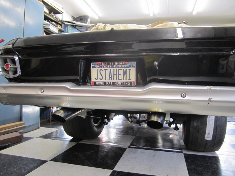

you can get away with alot of stock parts in the street.Once you get traction at a track is where your weak links will start breaking.I broke alot of sh......................parts through the years.How many times have I heard someone say,,,,,,,that's not supposed to break!

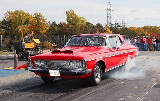

I have run 10.70's in my 3700 lb 63 with alot of stock parts that really should be replaced before they break. I am still using a stock 8-3/4 rear with 4.30's that has held up fine so far and it still has stock axles. But I only have 7 passes on my 493. Its a 440 with a 4.15 stroker crank. Its a pump gas eng and I race thru the full exh and even drive it to the track most of the time. I am also using an 850 DP carb Holley which is nothing fancy. Body is all stock and I use a stock gas tank. I did upgrade to a 3/8 sending unit and 3/8 fuel line. Built my 727 myself and I uses stock Mopar clutches and steel plates. The only updates to my tranny are a bolt in sprag and a reverse manual valve body. I use a Dynamic 9.5 converter also. I do plan to pull the tranny out soon and update the front drum. I have a steel eng mount on the drivers side and the stock rubber mount on the passenger side. The suspension is all stock other then SS springs and 90/10 comp shocks up front. So far the best 60 is 1.50 at 10.76 on 30 x 9 Hoosier radial slicks. Its a fine line on when to really start updating to heavy duty parts. My feeling was when my car was in the mid 11's alot of stock parts held up. But now I am worried so when I can afford it I plan to go to a Dana rear. Ron
