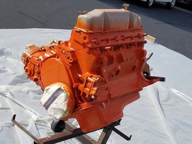

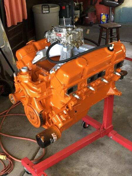

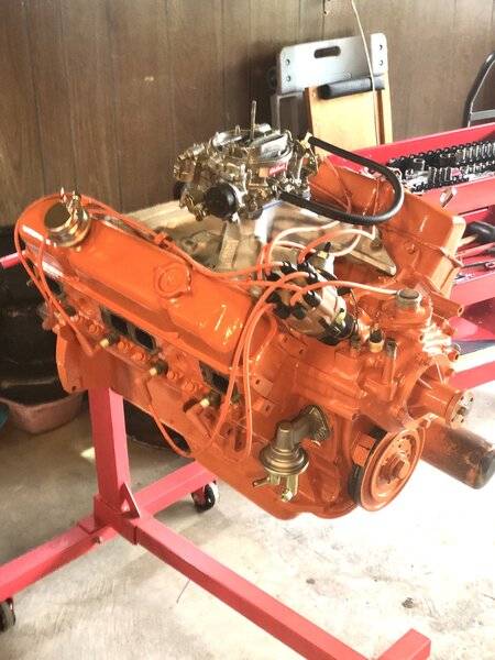

Looked at Kbs a little better, after Hirsch had nothing. KBS at least has the race hemi orange i need, and has a paint system of products. Gonna give them a try.I use KBR high temp. They specialize in that stuff.
Used their primer and sprayed it both.That look sweet. You used their primer? Sprayed everything or brush?
I bought direct from KBS. They shipped out pretty fast. I'll agree with Hemibee the primer is key.Looked at Kbs a little better, after Hirsch had nothing. KBS at least has the race hemi orange i need, and has a paint system of products. Gonna give them a try.
(Even less expensive than the three garbage spraycans i got from mopar!)

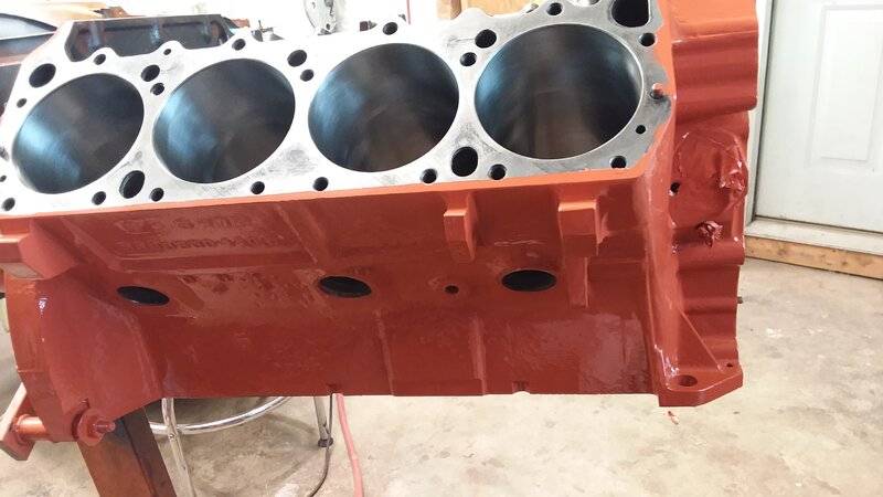

KBS Motor Coater Engine Paint Kit used here.I have a 383 out for repainting and fresh heads. I could use some feedback from those who have had success with engine paints.
