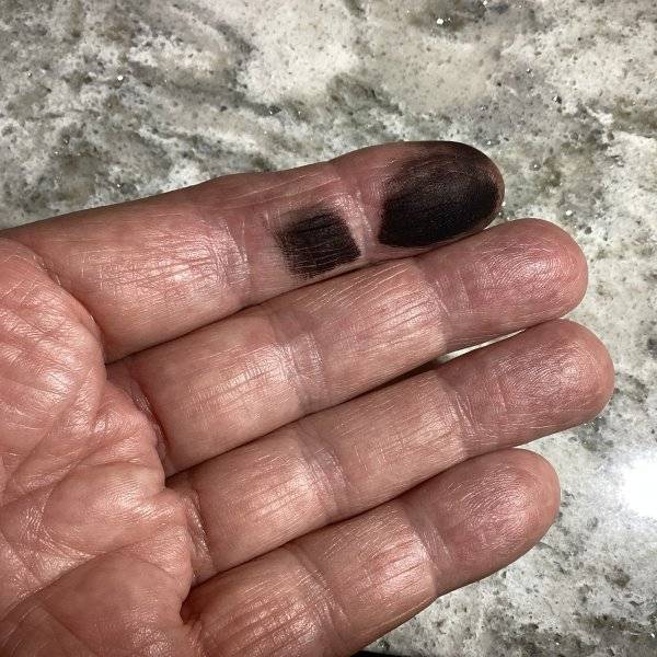

The points in your reply is what started me down the path of an Afr. As a new rebuild I smelled what I thought was new paint burning off was actually gas.
I’m learning as I’ve never had an engine that wasn’t to factory specs as now I have a stroked 440.
Pic is from wiping inside of exhaust pipe.

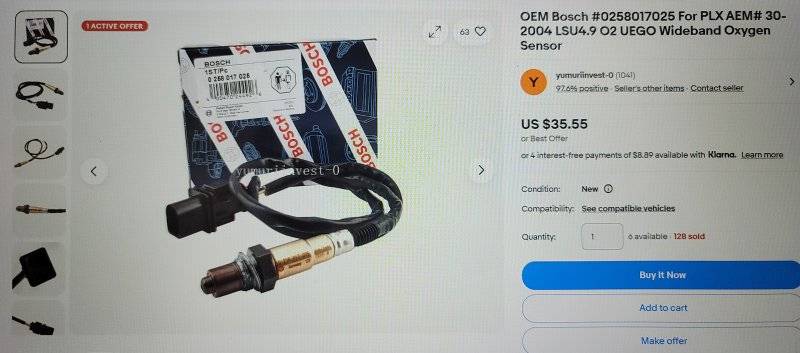

The Bosch O2 sensors are not that expensive from some sellers on Ebay. I put one on each side
of my exhaust system and will unplug and switch them for each side. I think I paid around $30.00
for an exact replacement on EBay. I used the Holley Sniper O2 gauge and kit and added the extra
sensor. The sensor that came with the Holley kit was clearly marked "Bosch" with the model number.
Don't go and buy a high priced sensor for the other side!

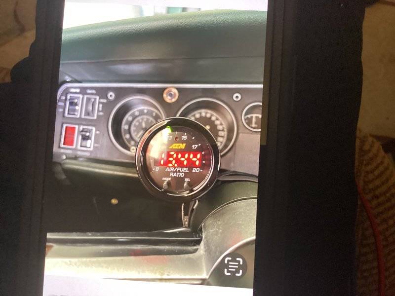

Half way through the install. I had to wait to get bung welded.
Hopefully complete by this week.
Reading with interest.
First start up at idle.
I won’t have any new data as I have major brake issues to tackle first.
