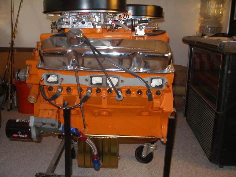

This is MY 440 built as a Maxie:
Im running TTI headers BUT these Heads are 452s Heavily ported...

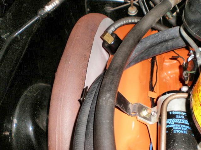

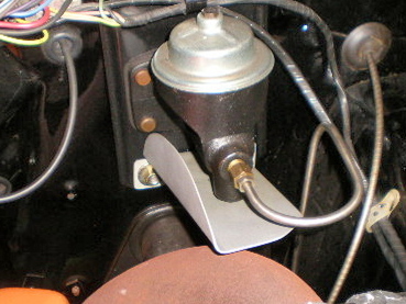

The manifolds will fit but you will have a clearance issue with the booster if you have power brakes.Also,the right side manifold will fry the paint on the valve cover,the left will boil the brake fluid,Max Wedge cars weren't meant for extended driving if that is your intent.I made insulators out of sheet aluminum to solve that problem with mine.P3150428.JPGP3150429.jpg

The manifolds will fit but you will have a clearance issue with the booster if you have power brakes.Also,the right side manifold will fry the paint on the valve cover,the left will boil the brake fluid,Max Wedge cars weren't meant for extended driving if that is your intent.I made insulators out of sheet aluminum to solve that problem with mine.View attachment 242231View attachment 242230
this is an early b-body. with the engine moved back 1 1/2" and an inch or so to the driver side, would the master and steering column still clear?

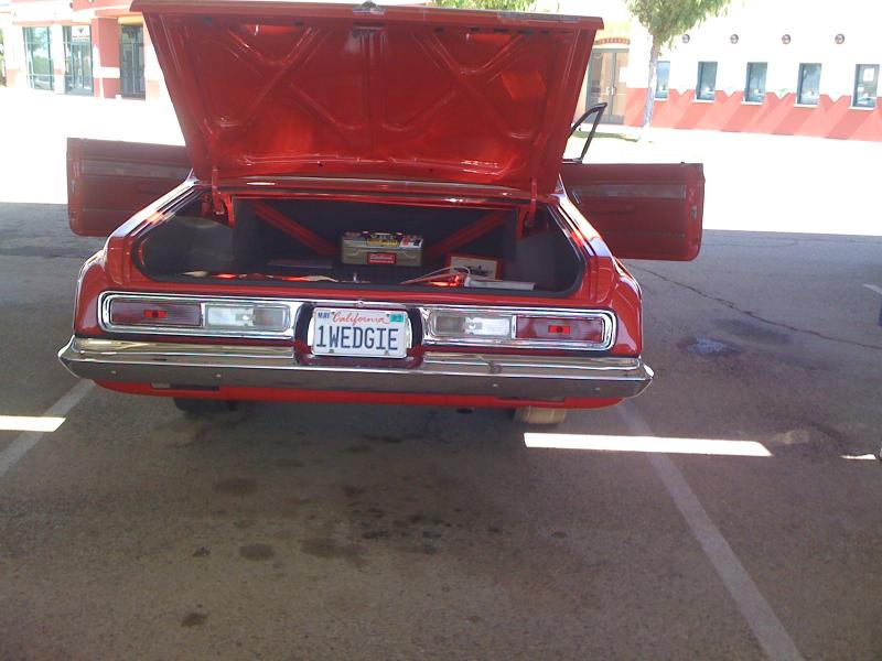

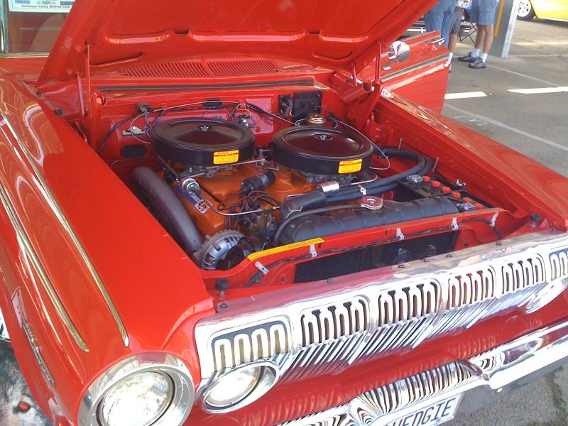

This is my "Bud's" Maxie roaming around (occasionally) So Cal
He is an old timer now...
He will be at Van Nuys Spring Fling
