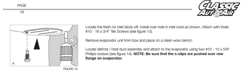

The cowls were cleaned prior to me buying the car from the guy who restored it. The car is garaged. So, the cowls are clean. My oem vents were removed and blocked with metal plates and gasket sealer per Classic Auto Air instructions for an aftermarket AC system.

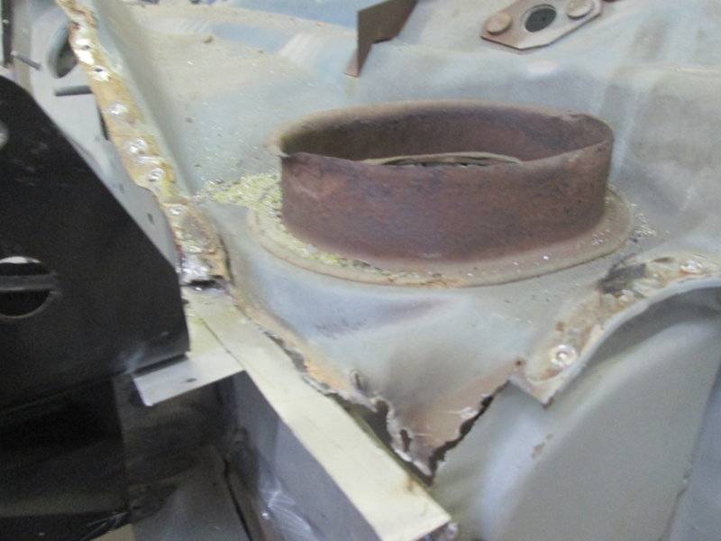

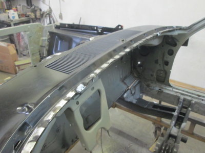

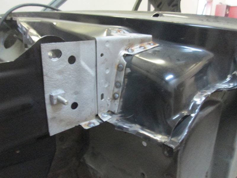

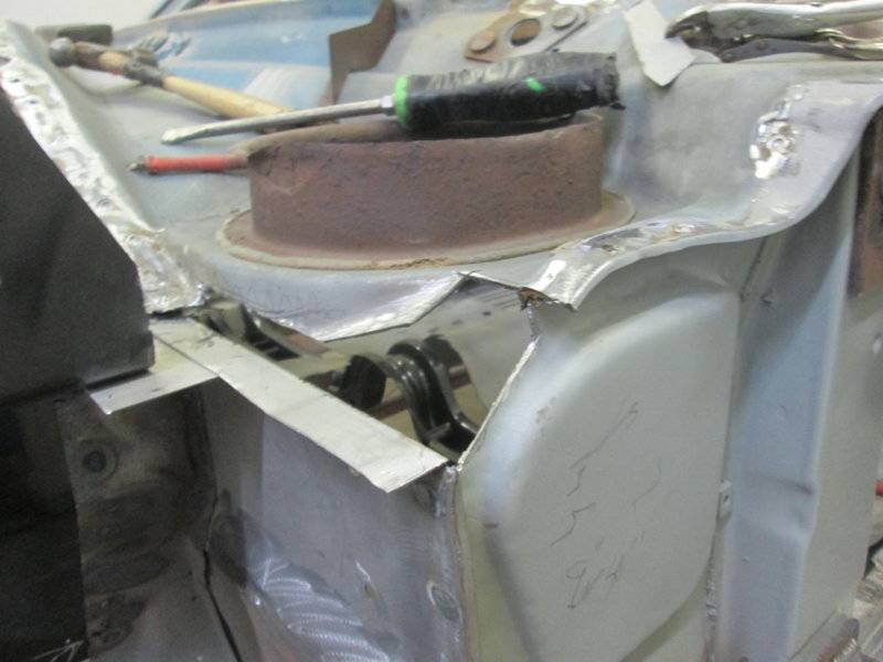

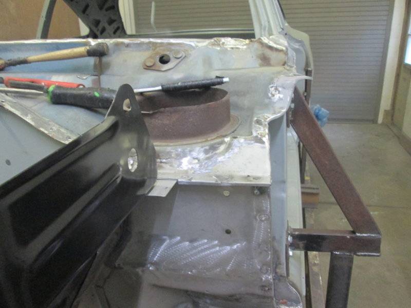

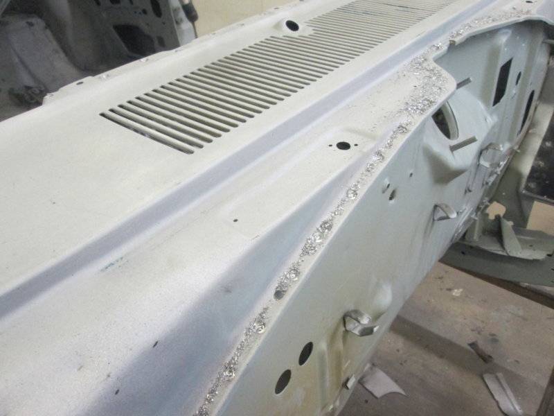

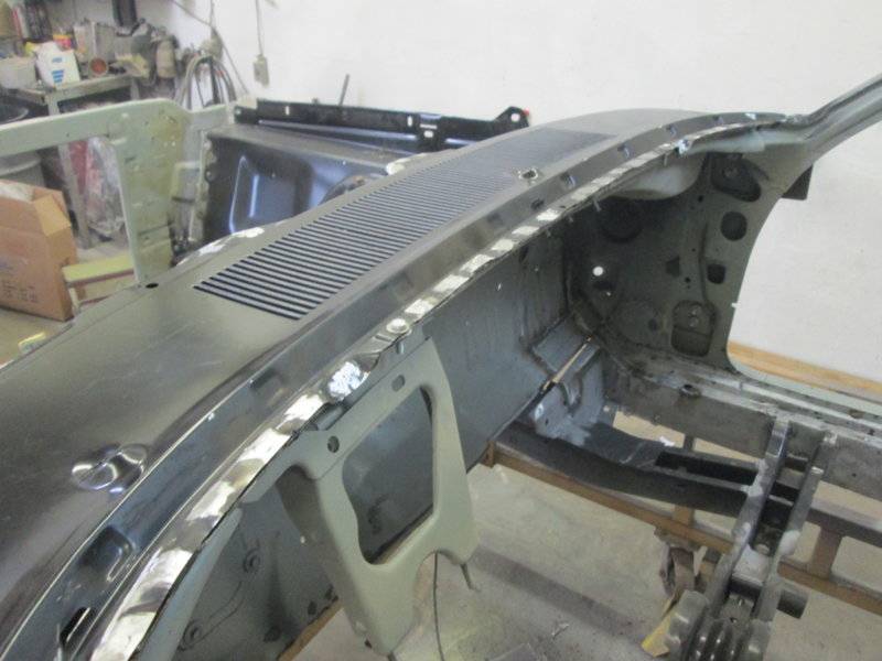

We found where mine was leaking for years!! 2nd last picture shows the drain slot you are talking about, it is designed to drain into the lower cowl and out of it behind the tires from the poorly positioned hole shown in the last picture. No wonder they rust out, as the water sits in there.
beeresto2016bodyshop 734.JPG beeresto2016bodyshop 758.JPG beeresto2016bodyshop 761.JPG beeresto2016bodyshop 827.JPG beeresto2016bodyshop 364.JPG
Last picture shows the drain slot you are talking about, it is designed to drain into the lower cowl and out of it behind the tires.
Thanks for the photo. I'll see if I squirt some water directly into the drain holes and see where that goes. If it comes out through the cowl and on the floor behind the tires then the windshield gasket must be leaking. Right?

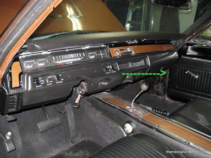

If it's coming down the firewall.. your lower cowl is leaking, probably from rust just like mine was. If your windshield seal leaks it should be dripping on the back of your instrument cluster / brake pedal support.
View attachment 587214 View attachment 587215 View attachment 587216 View attachment 587218 View attachment 587220
what you showed in the pictures is what exactly what I was talking about in post #2. It's a common problem with our older Mopar cars
