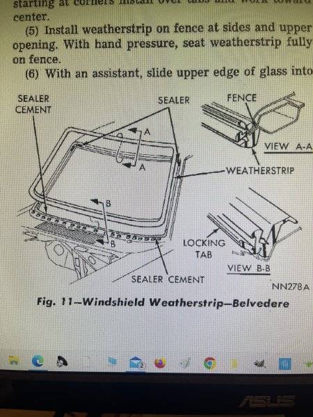

Ok so it looks like the bead of bedding compound/sealant is between the gasket and body/pinch weld (the whole perimeter) only. So no issues with the glass in the gasket leaks I presume.
Factory was across the bottom and up each side a little bit - somewhere in the neighborhood of 4-6 inches I would guess.
For other in the future…
FSM “sealer cement” shows upper corners as well. Wayne did the whole perimeter and I don’t see why I wouldn’t as well. If it doesn’t impact fitment then it’s kinda a no brainer. Especially if it might help stop leaks as sealers are meant to do. Knowing Chrysler some VP bean counter probably asked “do we have to glue the whole thing? We can save 12 cents a car if we just do it this way”.
I added bedding compound to the lower channel and up the sides about 10". It cleans up fine once the lock strip is tucked in and it bars any moisture from fogging the lower half of the glass.
