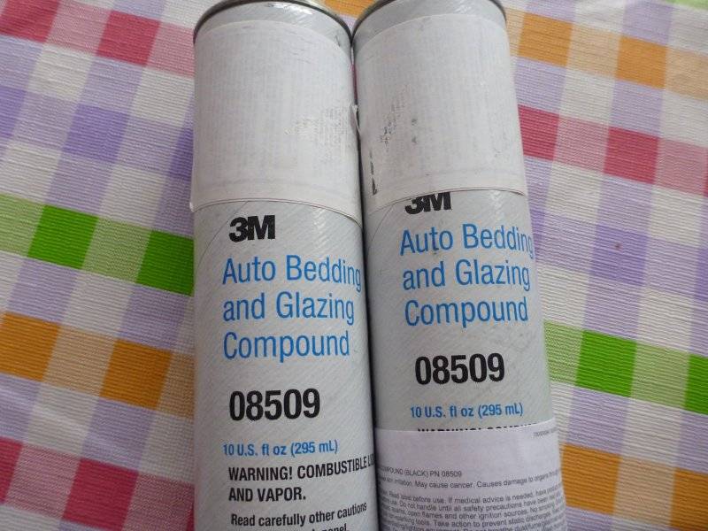

3M8509 has been the "go to" or preferred for body to rubber in these applications.
It is skim free and "non setting".
It is discontinued with no comparable replacement.

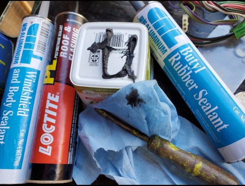

CR Lawrence 7708 is non setting and stringy.
CR Lawrence 777 skims over and I'm currently "testing" it for solvent removal after setting.
It is stringy as well. (Messy)

Again all shown in my Bee restoration thread. Unfortunately I don't think they're making the BUTYL 3M Auto bedding and glazing compound anymore, so you may have to look around for something similar. Urethane is not what you want.

Ok so it looks like the bead of bedding compound/sealant is between the gasket and body/pinch weld (the whole perimeter) only. So no issues with the glass in the gasket leaks I presume.
Since it's a hot topic.
777 can be removed with mineral spirts after firming up.
It can also be smeared after 48 hours.
Similar to a bubble gum consistency.
Just a quick test.
Between the 2 CRL products that is the one I would use for a new install in the type I have under consideration. (Post 2)
I have used 7708 for extra for a channel fill in addition to the butyl rope back glass.
But think it is too runny for a rubber gasket type of use.
