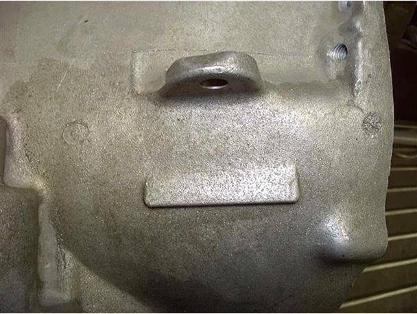

Still can't locate matching transmission number
I can not locate my VIN number on my 727. I have an AAR 'Cuda and have been able to match all numbers except the transmission. My transmission case looks EXACTLY like the one in your picture below, and for the life of me, I don't see a number on that picture either.
Is the number viewable with the transmission installed in the car? What am I missing? Any help from forum members, especially the original poster, will be appreciated.
Often I or anyone for that matter asks to find out what type of transmission they have in their old mopar. There are hundreds, if not a thousand, of threads on this website identifying, discussing or assisting with this process, troubleshooting or repair.
Because of this large number of threads and the fact that using the search option is unbeknownst to some members, I have put this together.
The passenger side carries with it (if its 69 model year only) the complete VIN of the vehicle, 1970 and above have the year, place of manufacturer, and serial number of the vehicle it was made for, see below:
WELL THAT ABOUT DOES IT.. HOPE YOU ALL GET A LITTLE INSIGHT FROM THIS.. I MAY ADD TO THIS AS I GO ALONG.
Look on the pan rail
If the pad is blank then it is a warranty transmission, your VIN would not be on your AAR anyway as the full VIN was only done in 69 year, you would have had a partial VIN on the pass side boss/pad in 70
