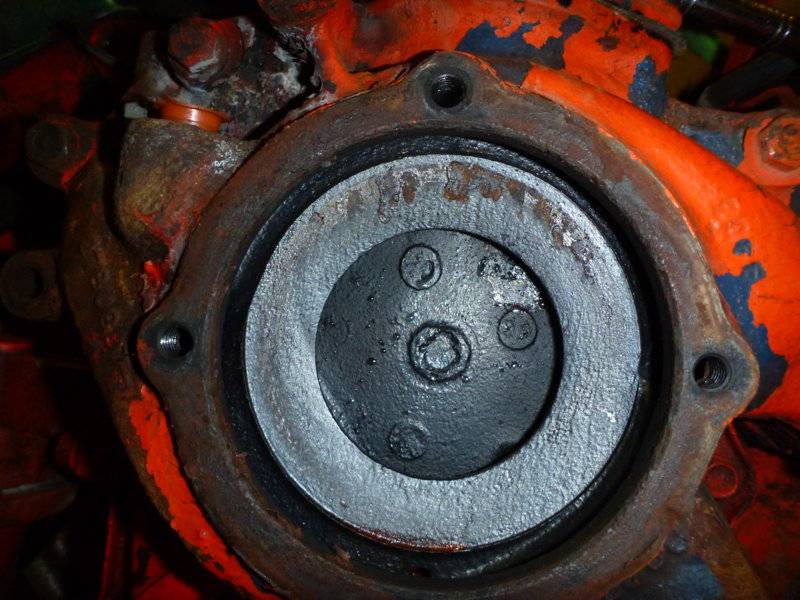

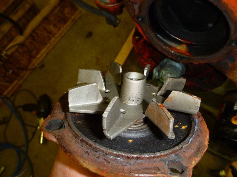

30 years on same coolant, most of the time sitting. In so nice of shape and the seals still good I just cleaned up and reassembled on my restoration.
