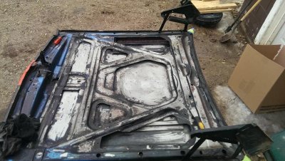

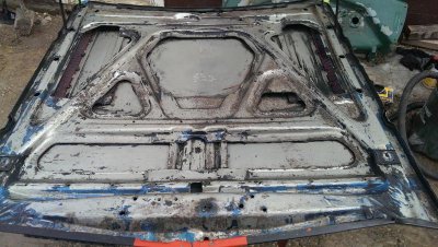

I also put in some time trying to de-grease and scrape several layers of color, stickers and grime from the underside of my hood so it can also be cleaned up and painted.

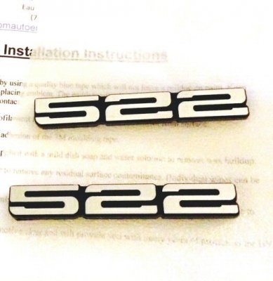

Here's a pic of the after of the hood (found orange, black, blue, green and silver) as well as something else that finally showed up that put a huge smile on my face
