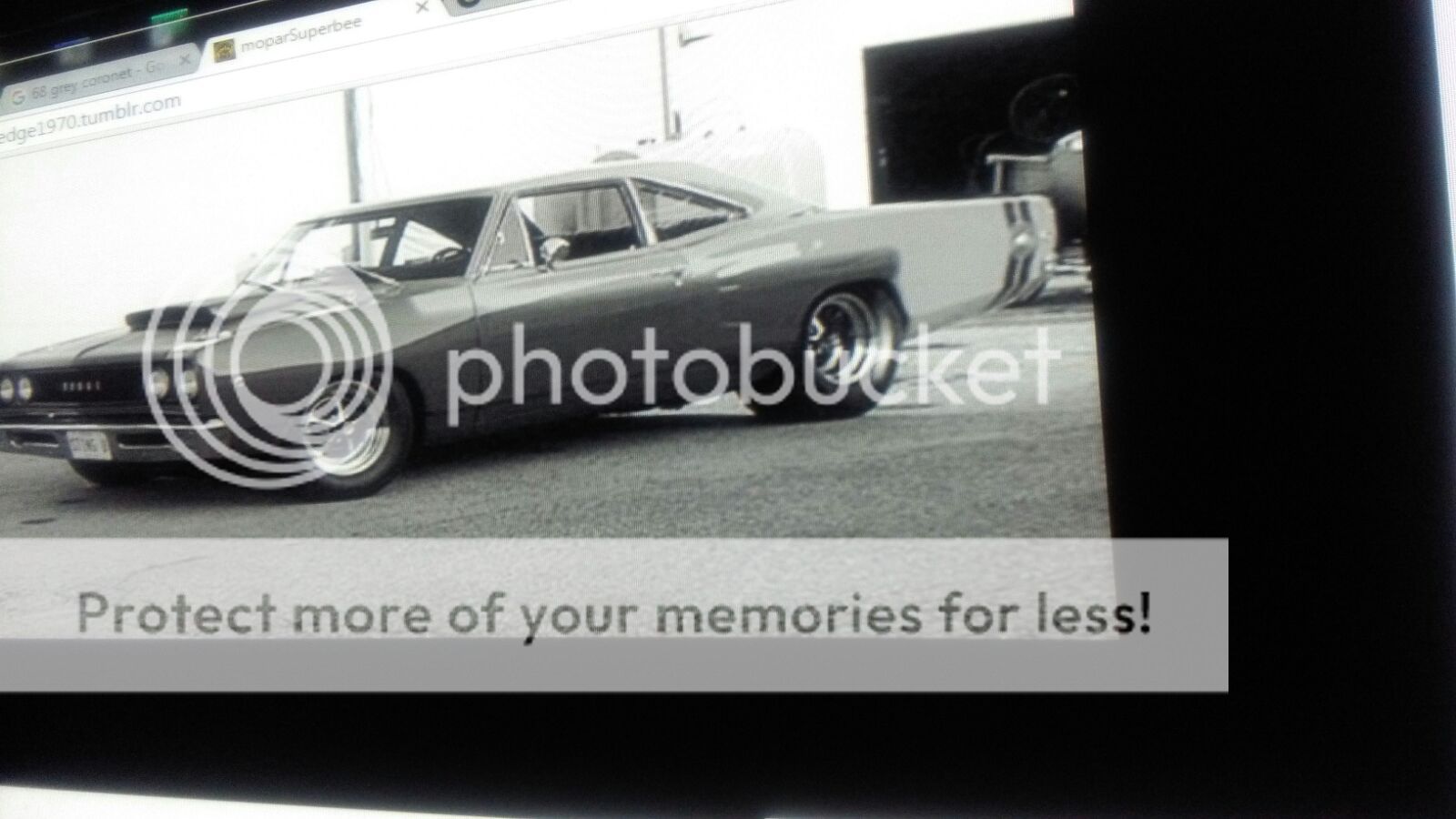

Pic below to give an idea of the sort of look id like. I do understand there's mods done to it. But to have an idea.

A couple of questions how much are you willing to modify your car? How close do you want to get to the look of the car you posted? The car that you posted is probably back halfed pro street, so entirely custom rear frame rails suspension, narrowed rear end etc. The wheels on the back are probably 14 inches wide. If you don't want to do that Coker has a 285/70/r15 big silver town that would give you a similar prostreet profile sidewall, but not wide enough that you had to modify frame rails etc. It's a big tire. Its no where near the width to get the race car look.
The first picture is Bitchin. Also not practical for street use. Looks tubbed. 295-50 15's on an 8" rim on the 69 pictured. Your car looks good the way it is.

You might get 1/2 the width of the tire in the B&W photo. Stretched lips and tubs will give that look.

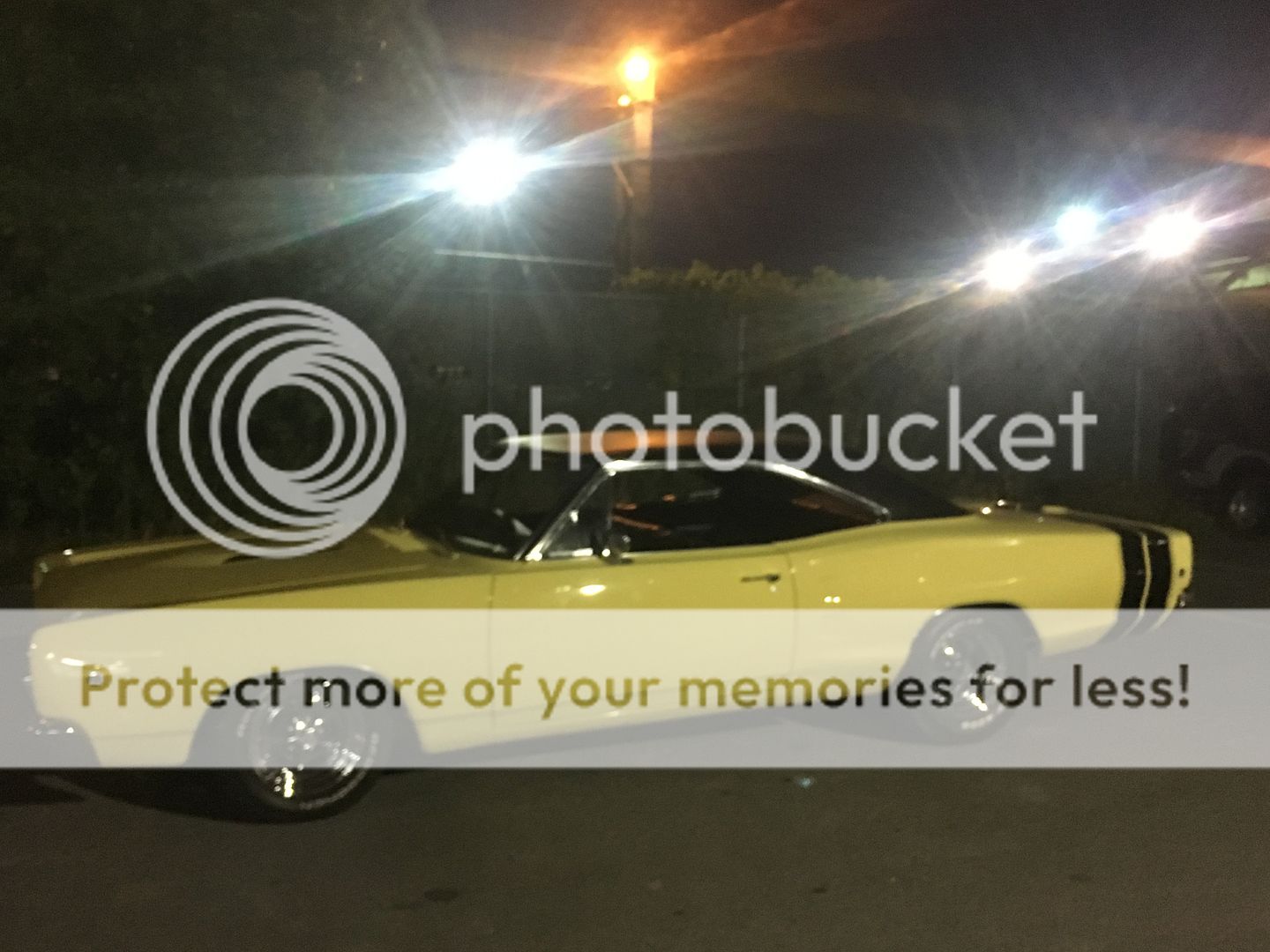

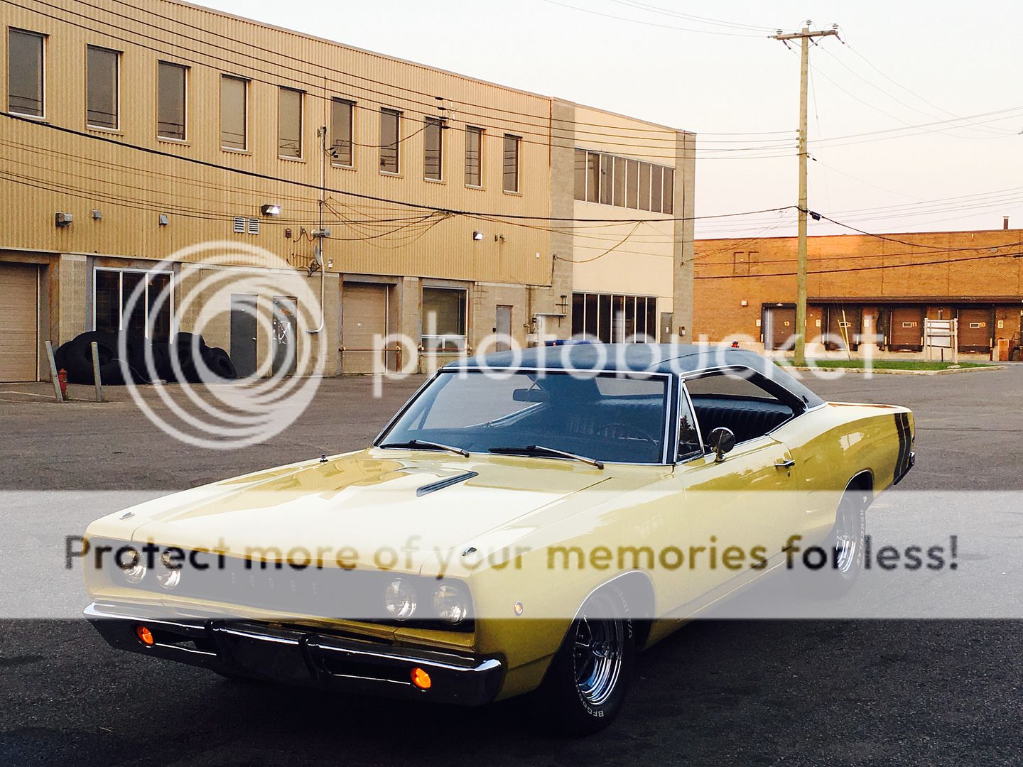

My car :

When I had bought the car it came with 235s in the rear..which I pulled off in a day or so lol hated the look. Went with 275/65s
Now I'm wanting a bit more .. so thought of 295s.
