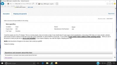

First off, I bought an engine from a gentleman out in Las Vegas. This was his eBay ad:
I just happened upon it right after he first put it up and immediately contacted him requesting video of it running. He graciously provided same:
Sounded good to me, so the deal was struck immediately and he took it down off eBay - even though I reminded him that if he left the auction alone, he'd surely get more than what we agreed on.
He'd hear none of it; we had a good long talk and he was happy it was going to a good home.
