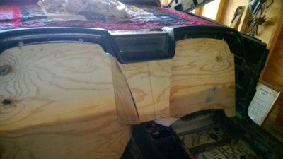

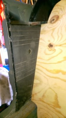

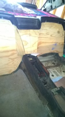

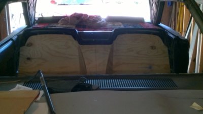

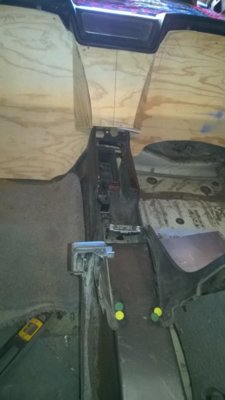

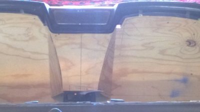

Redid the seat topper cross mount and hung that. Got out the plywood to make a back panel and the down tunnel to the console from the center. A few more pieces and it's done but for the 3/16 foam backed fabric to cover it all.
