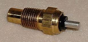

My temp gauge reads low too, all other gauges are ok, is this the one you got from 440 Source? or did it have the threaded stud like the stock ones?
the pic is whats on their web site

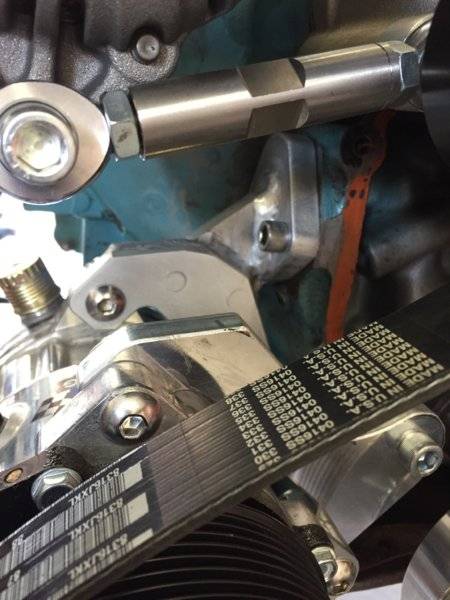

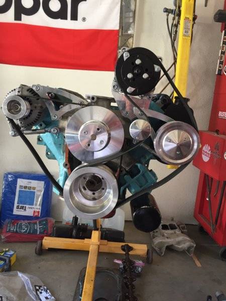

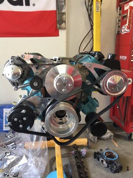

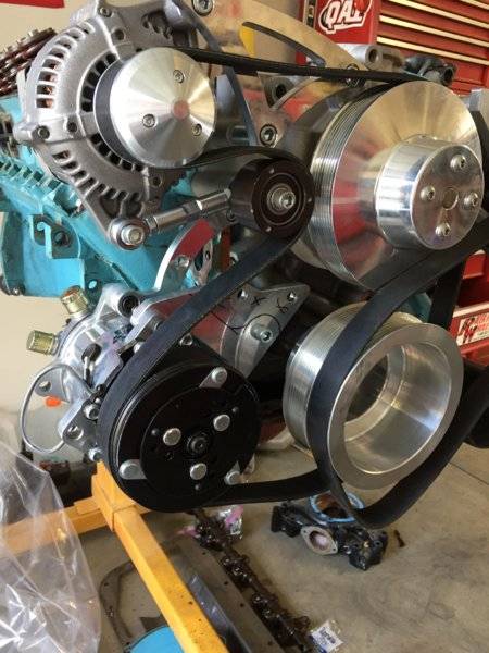

That looks much betterAs some of you know, I bought the CVF Beast serpentine set up from Derwud. Well after taking a long hard look being mocked up the way CVF has it, I didn’t like it. So I set out to drop the ac compressor down low on the passenger side. It’s almost done, just a few cuts and it’ll be ready.
View attachment 525467 View attachment 525468 View attachment 525469
I guess I heard or remembered that wrong...memory dump commencing in 3, 2, 1.
Sorry, guys. I'm taking 2 different migraine meds and they're taking their toll on me. My brain feels like Cheech and Chong when the smoke cleared and they discovered they were parked in the center median.The temp sender on mine has the un-threaded tip matching the wire connector on the new M&H under hood wiring harness.
I think someone once said not to use thread tape because it causes grounding issues making the gauge read inaccurately.
I know that's what it's supposed to look like, that's what mine looks like. I bought mine from napa a few years ago (aftermarket) and it reads low, so did the one before, @beanhead said the one from 440 source read correctly compared to the parts store ones that read low.The threaded portion inside the pump looks close, but the exterior nub where the wire connects to doesn't look right at all. This is what it should look like....
I think that"s another one that the parts stores sell, maybe not.
RC is showing the correct one at least for my car, the one I got that didn't work looked just like that... The one from 440 source that does work required me to put a female spade connector on the wire and clip it on the end, as it did not have the threaded nub like the original... the factory wire connector was cracked and overcooked anyway so I didn't mind clipping it off...I know that's what it's supposed to look like, that's what mine looks like. I bought mine from napa a few years ago (aftermarket) and it reads low, so did the one before, @beanhead said the one from 440 source read correctly compared to the parts store ones that read low.
Thanks, I think I'll try it, my connector is almost 50 years old and still looks great, I'm sure I can make a jumper easy enough, it's fairly hidden anyways.RC is showing the correct one at least for my car, the one I got that didn't work looked just like that... The one from 440 source that does work required me to put a female spade connector on the wire and clip it on the end, as it did not have the threaded nub like the original... the factory wire connector was cracked and overcooked anyway so I didn't mind clipping it off...

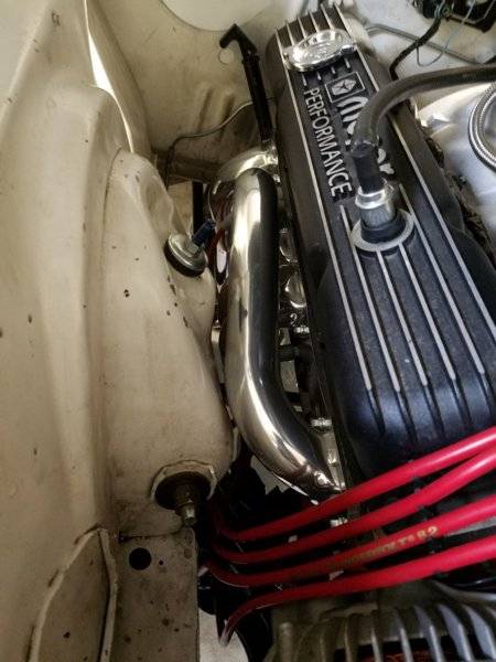

So pretty.Finally stepped up to some tti's....I must say, as far as headers go, a joy to install compared to the old-tyme hookers and such I've used over the years...and I was shocked that I could actually spin the spark plugs in with my fingers wrapped around them!
View attachment 528751 View attachment 528752
