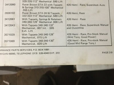

3571029 looks like it may be the “725” cam.
Will get some measurements off the cam itself.

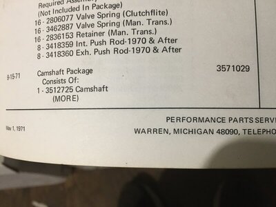

Looks like that second pic from Silversedan answers the question.:thumbsup:
It seems that in typical Mopar fashion....... the number on the part...... is not the “part number”.
The "P" number includes the lifters.... "Camshaft package".
I don’t see a “P” in the pics of the numbers in those pages.
Was the cam available/sold as an individual part without the lifters?
I don't believe you could get the cam separately.
After the change from Direct Connection to Mopar Performance,"all " performance part numbers started with a P. That included any part that was considered performance orinated in any factory performance car.If the same part was used in both performance non,all it did was increase the price of the part.
