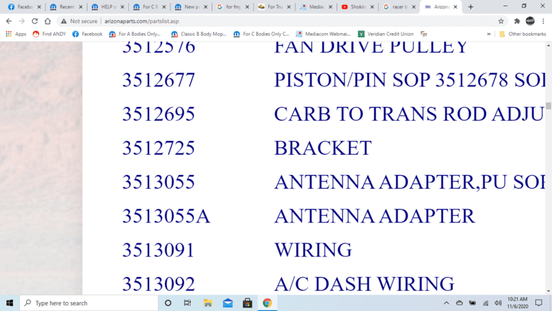

Wrong part number. #3512725 is a bracket. http://arizonaparts.com/partslist.asp

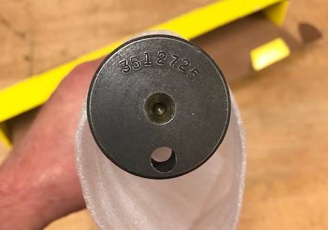

Interesting... A Mopar screwup??
But, I'd believe a Chrysler part with a number on it, rather than a description.....
