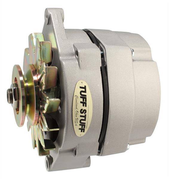

This is a pix of a GM 10 SI or 12 SI alternator....WHY would you put it on a Mopar? ...inquiring minds want to know.......

I prefer the single wire and it works perfect with my billet aluminum brackets. Add to that the fact that it's readily available. That's on my pickup. My 63 has a mopar alternator.

The GM 10 SI or 12 SI are excellent performers.....reliable design, good available of parts, and good capacity capabilities.....but on a Mopar? What was wrong with the Mopar alternator?.....its just as reliable and available...ridicule you....No, i don't know you.....but good old Nacho has no real knowledge of electrical systems and their design or function . If you want to discuss my capabilities or knowledge, please PM me.
