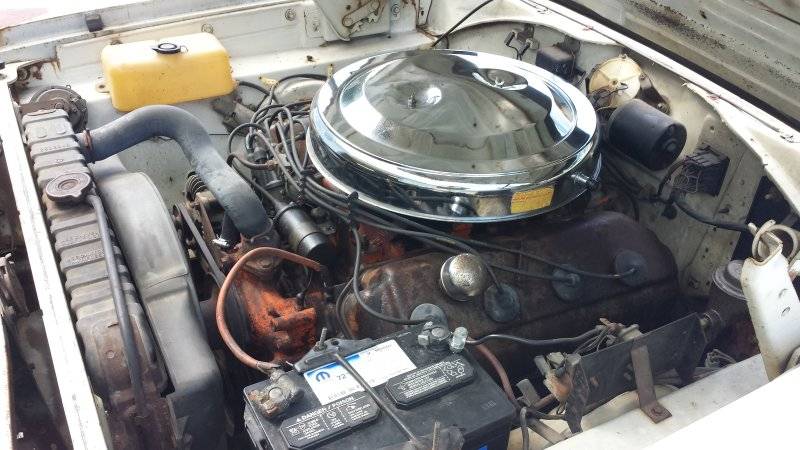

Notice how much is painted on my original negative cable.....

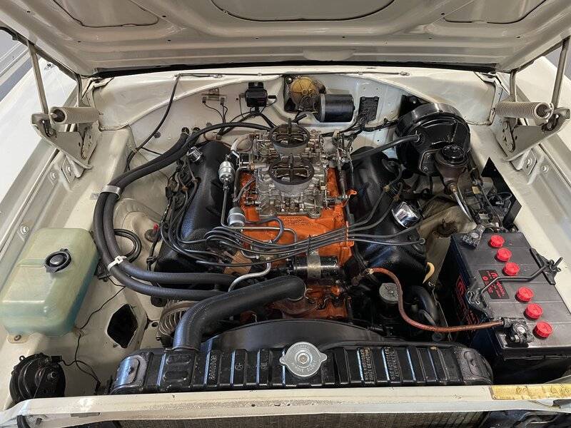

Your guys original cars demonstrate what I already suspected on mine - the PO used too reddish an orange paint to re-paint the engine In mine.
Yep and could never figure out why they got that carried away on the negative cable. I'm getting old and senile, don't want to mistake it for the positive !! My real paint mission was to get the bolt head and nut holding the strap, thought I'd get a bit of the cable while there.

OK - but I suspect with a more correct shade of orange.

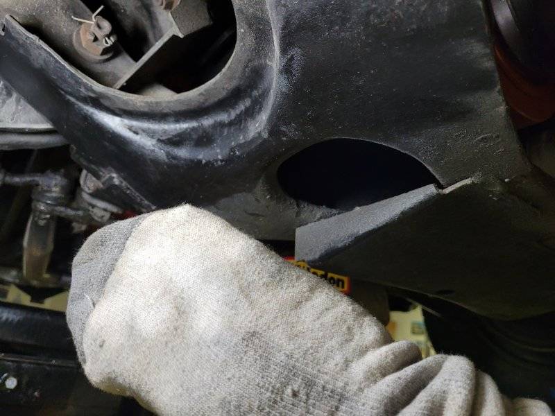

Why you never throw out your holey socks!

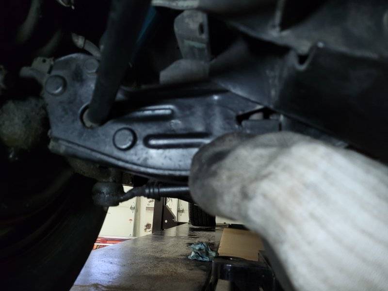

Dip in gasoline and wipe...
This might take a while..

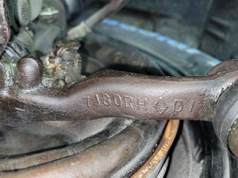

Signs of a true hemi car. Axle bump stops are large and rounded, not pointed. No idea why they bothered vs the normal pointed ones on every "regular" car.

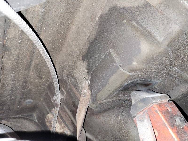

Reinforcing plate welded on top of the normal pinion snubber area on the car body. Adjustable pinion snubber here is obviously aftermarket.
