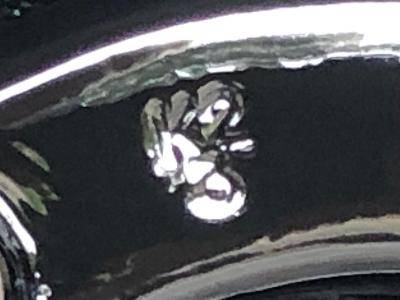

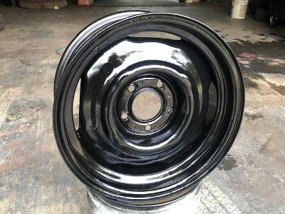

Do they look like these?

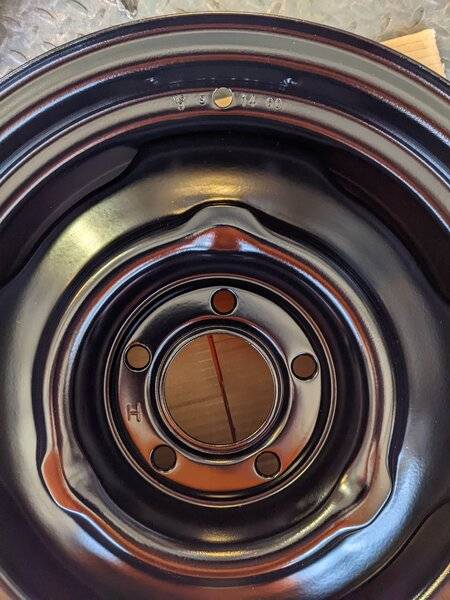

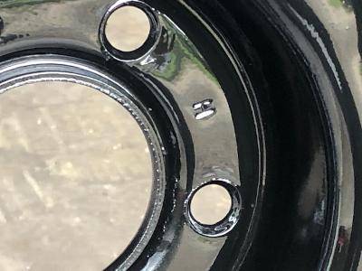

This looks like an H:

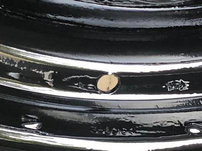

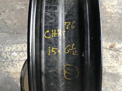

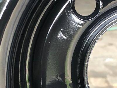

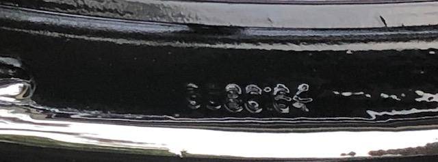

These are 6.5" wide.

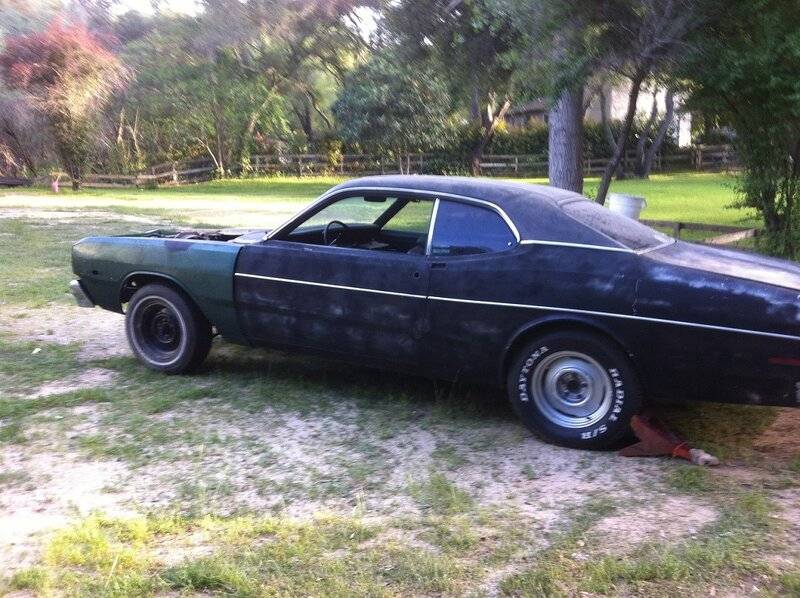

This and another matching wheel came on a 73 Dart Sport 340 that I bought in 2014.

I'm sure there is no value for these. I just wondered what is so special about them.
6 " wide and a large H, 3 nubs mostly dimpled but not all are A12 wheels. The black wheel above with a small H is a good looking wheel but not for A12 correctness.
The H is much more prominent than that, and the A12s were 15x6. There are repops of the H wheels out there, but the valve stem is in the wrong place, and A12 experts can tell the repo's from 20 feet away. Then there is the question of how shiny they were, satin , gloss or what.....
There is a good tutorial on the H wheels on the Liftoff hood playground.
The H wheels used at Lynch Road during the 1969 model year were built at the Motor Wheel factory, plant 5. Hence the first detail required - M5/9 or M5/8 marking to the left of the valve stem. The centers are 3 dimple with one lug hole aligned with a dimple. They have a press mark on the back of the dimple from the center stamp process. The lug face is flat, unlike the 68 H wheels. There are many other details as well making them unique to the 69 model year.
