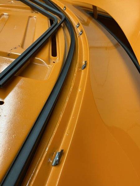

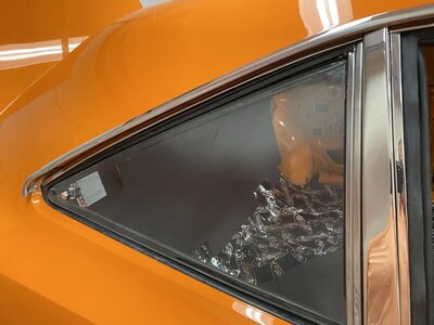

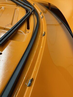

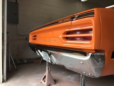

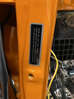

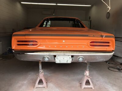

Well after 2 weeks of Beach Bumming it was back to work. Bumpers and window molding clips installed. Also added some more decal bling.

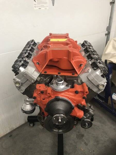

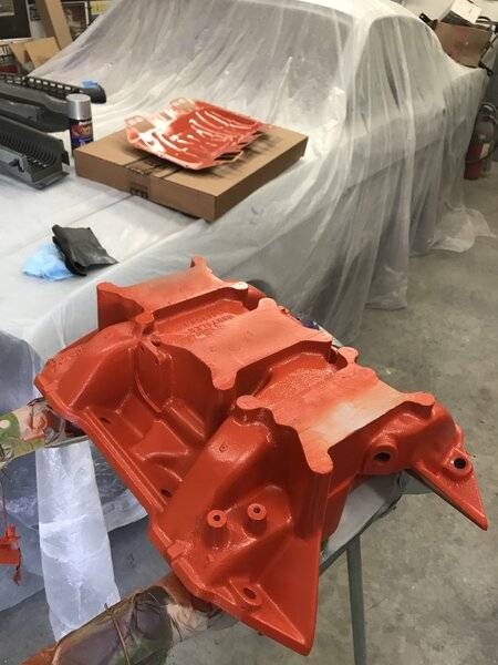

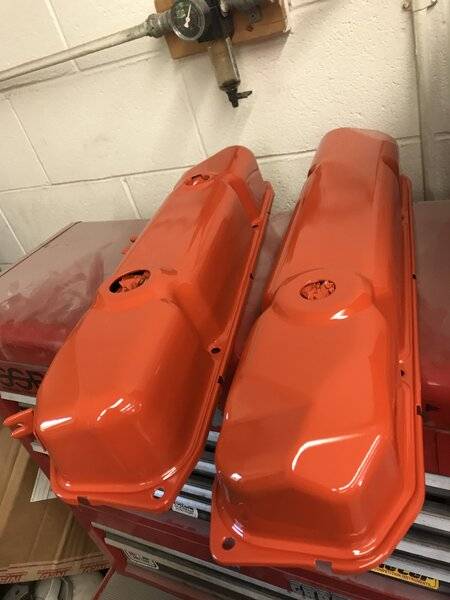

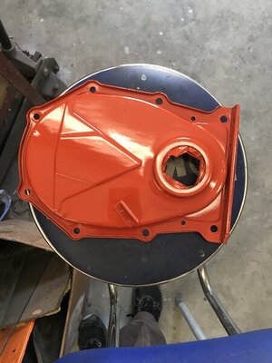

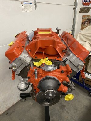

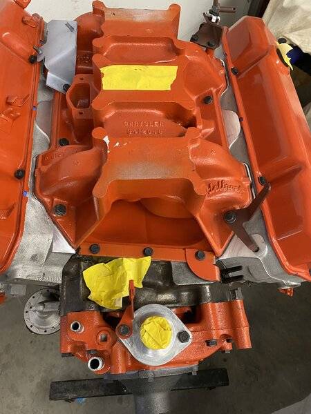

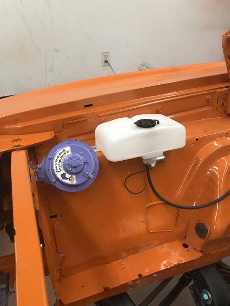

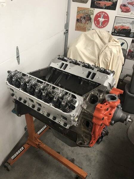

Painted the valley pan, water pump housing, intake, etc off engine to get better coverage before painting final coats after assembly.

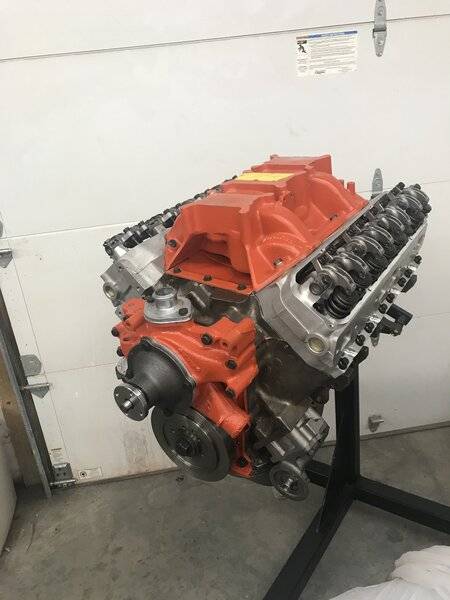

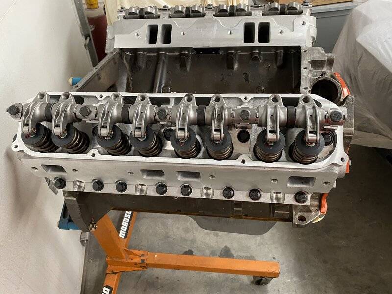

While checking valve lash realized the push rods were a bit short. Ordered new ones and got everything adjusted out. Almost ready for paint.

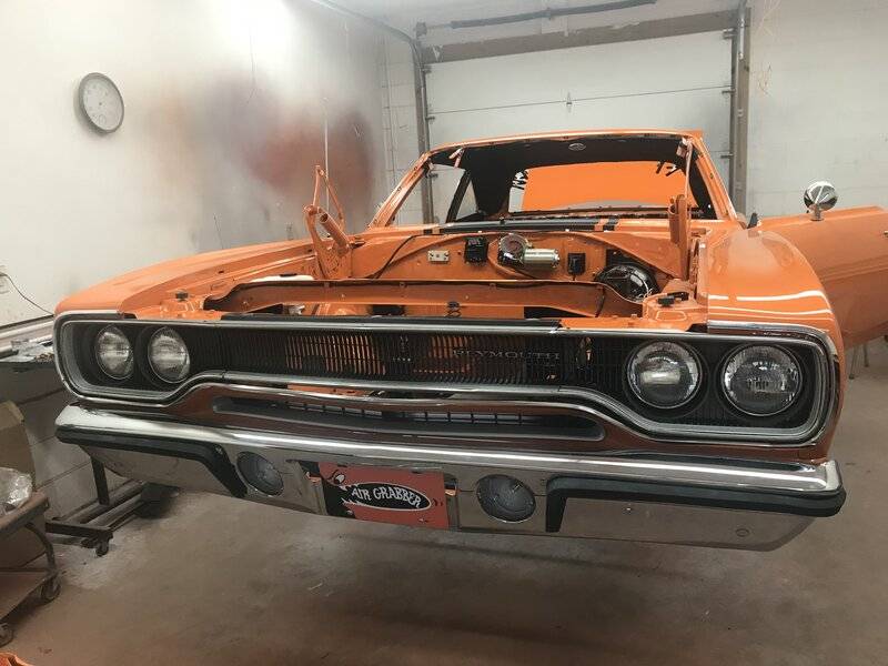

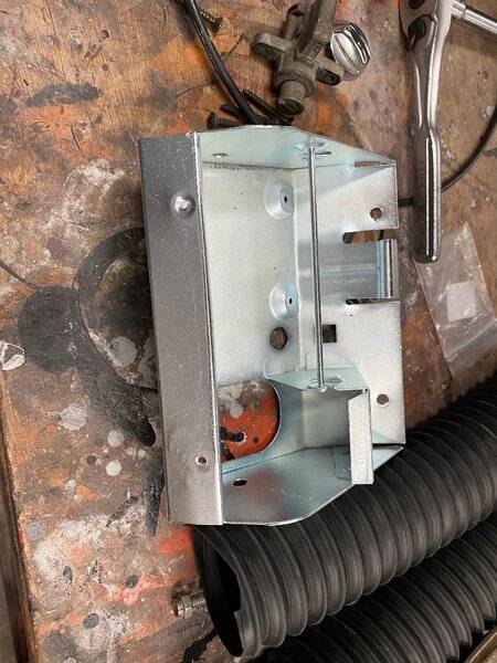

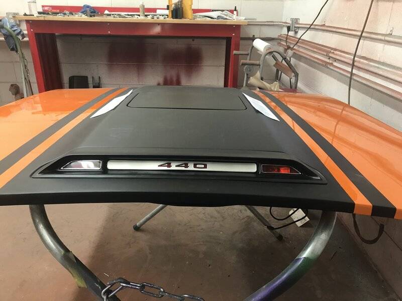

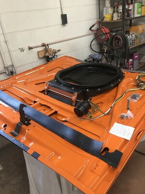

Reassembled the Air Grabber system on hood. Luckily the Grabber box itself had never been painted and cleaned up beautifully after a cycle in the wife’s dishwasher :D

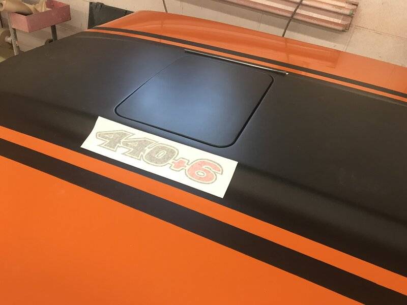

Got the hood turn signals and call out installed. Ready to put the decals on after a little more exact location research.

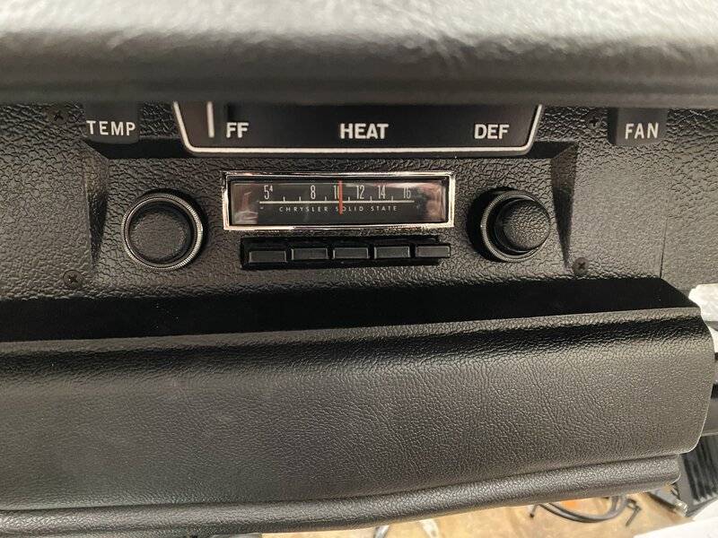

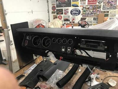

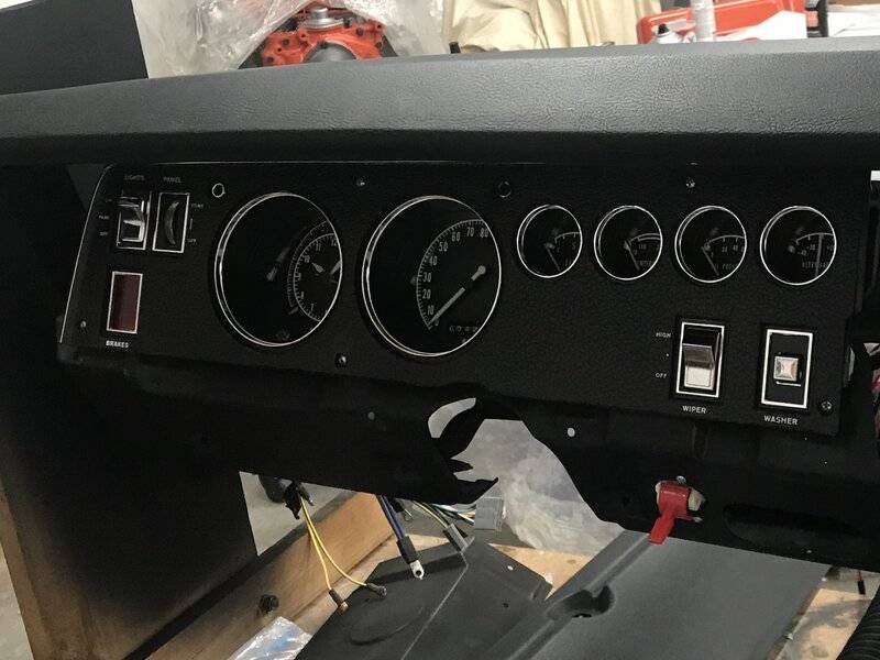

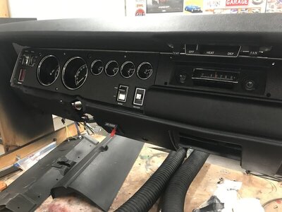

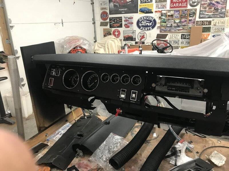

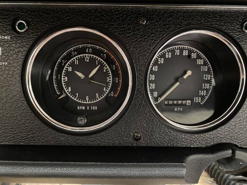

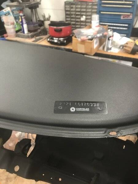

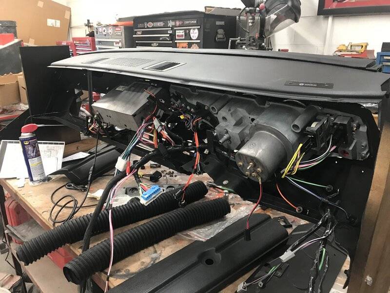

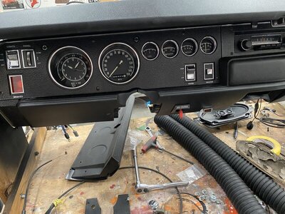

Building out the dash before install.After all the instrument difficulties with the turn around time as it’s assembled it was worth the wait. Hopefully will be able to get windshield and back glass installed in the next few weeks.
02C4418F-62DF-41B5-8C4D-12CBCA0FF6D5.jpeg 49D5FFF7-15C3-44B2-A83E-7C2C99AC4244.jpeg E2F1E494-D640-44AB-8BAE-C6F319079A19.jpeg 07C1FA99-0F00-432C-8BFE-B2C9829D3D60.jpeg View attachment 983330 A891E74B-5EDC-46FA-911C-CED05EB4CEC6.jpeg 5E4169F7-3E73-4D23-BE02-7168AD06D5FD.jpeg 19488874-14FE-4335-9C0D-6E14BC750BEA.jpeg 3FCFA88E-FA80-45C0-A21F-8A6CBB0B04A1.jpeg 14AF079F-CB9A-4097-986F-0C1400036895.jpeg
