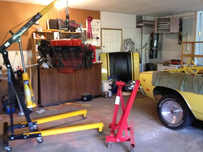

So, I have an engine stand, and a friend has a hoist. We switch off back and forth as needed, so I gave him a call, and picked up the hoist. He had just finished using my engine stand for his Mustang, so I had both at my disposal.
So, never having done this before, I took as many pictures as I could, kept safety first and foremost, and moved forward.
Most of you can likely yank an engine in a matter of a few hours - or less, but it took me quite a lot longer. Finally...
...and yes - I have since moved the hood around so it's not sitting on the corners.

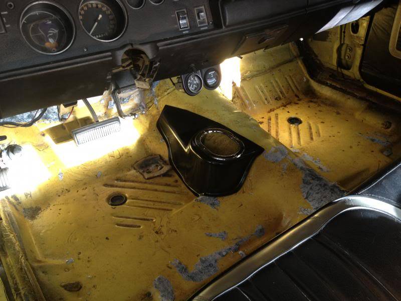

I got in there with spray-nine, windex, etc. and cleaned up as best I could whenever I had free time.
Its pretty straight forward. My advice here - WHEN YOU CUT THE FLOOR PLAN FOR THE HUMP, DO NOT, and I repeat, DO NOT cut the sheet metal over the torsion bar cross member to follow the hump. Just cut around the cross member, it is supposed to form a "shelf" so to speak. DAMHIK.

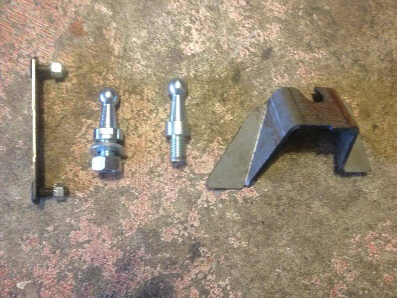

I didn't get any of the ballstuds and brackets with the "kit" I found, so I ordered some, and they arrived soon enough.

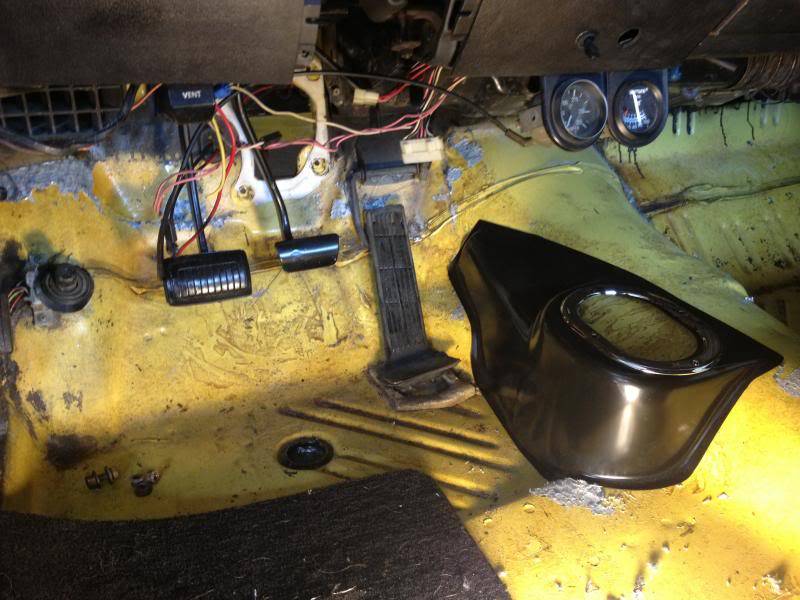

While I was waiting for them to show up, I pulled the original pedals and after a fair bit of tinkering, I got them in. One problem I had was trying to figure out the whole over-centre spring installation. I had everything all backward, then thanks to someone's help, got it all sorted out. Here's a shot of how the setup looks:
Next, I found the locating dimples in the firewall and drilled holes for the extra brace where the clutch pedal attaches to the floor.

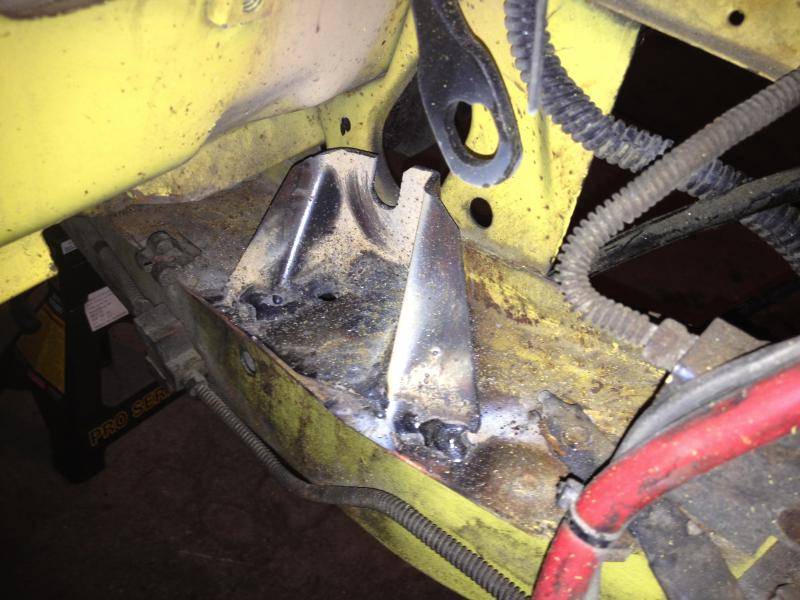

Then came time for the ballstud bracket installation. Searching the Internet, I found some great pictures showing just where it's supposed to go. A friend who is an accomplished welder dropped by and welded it all up for me. Here's the initial result...
...and after I cleaned it up and gave it a quick shot of rust paint...
I did NOT want to mess with a weld as important as the ballstud bracket, but did try my luck tacking in the 4-speed hump. Here's what I did - under close supervision.
After that, it was down to a quick cleaning, and voila!
