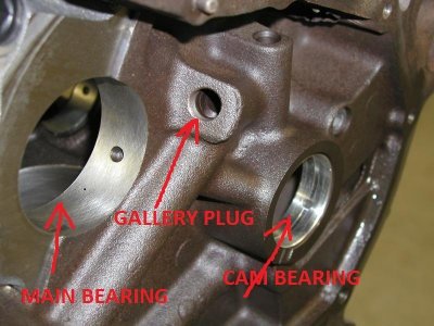

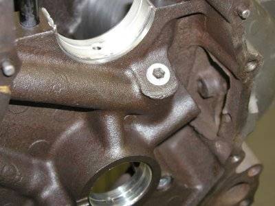

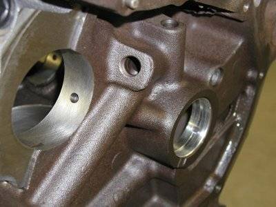

I forgot the gallery plug that sits under the front cam bearing. The oil was pumped out of the oil pump right back into the pan behind the timing cover. That was a 300.00 mistake I won't ever do again. Had to replace all of the bearings..Lucky though the crank was in great shape. The bearings were probably ok but to be safe i replaced them. You can see the gallery plug I missed in this other persons post. When the block is upright you cant see it. Thats why I missed it.
https://www.forbbodiesonly.com/moparforum/threads/440-oil-pressure-issue.72355/#post-910071022
View attachment 933769 View attachment 933770 View attachment 933773

Thankfully for me it was on the run stand when I figured out it wasnt getting oil.. So It wasnt so bad. An easy test would to be pull both valve covers and spin the engine over and see if its pumping oil to the rocker shafts. If not then you may have a missed gallery plug.

There are more than one gallery plugs in the engine... Most you can see easy I missed the one under the cam bearing.
