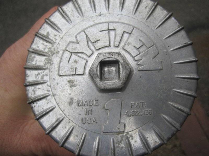

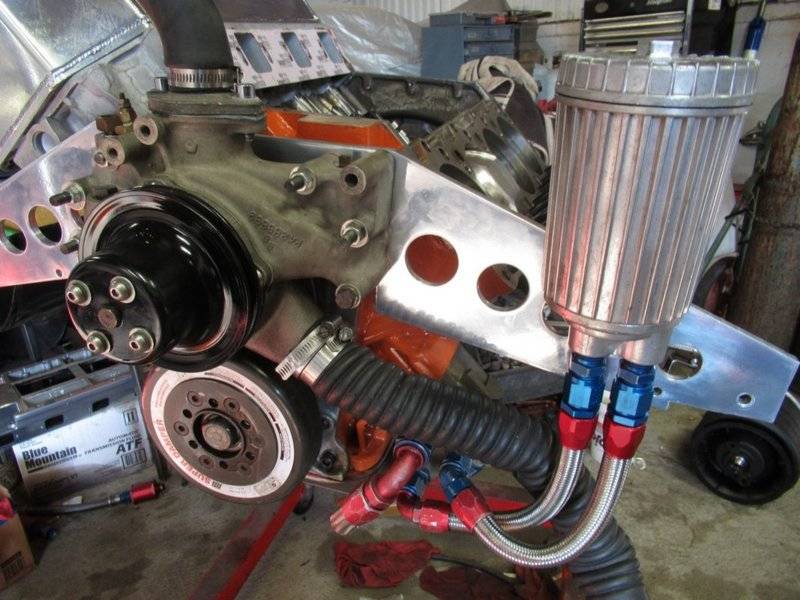

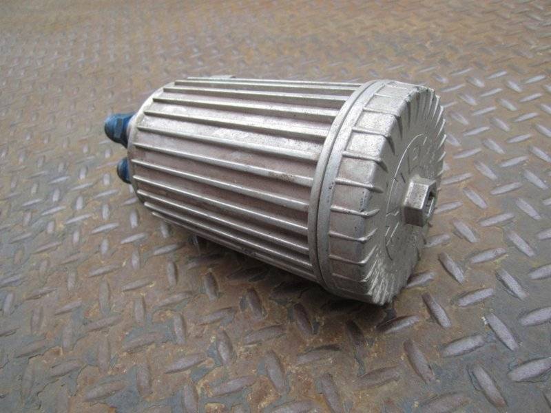

I now use a system 1 oil filter.Take the cap off anytime to check for debris.

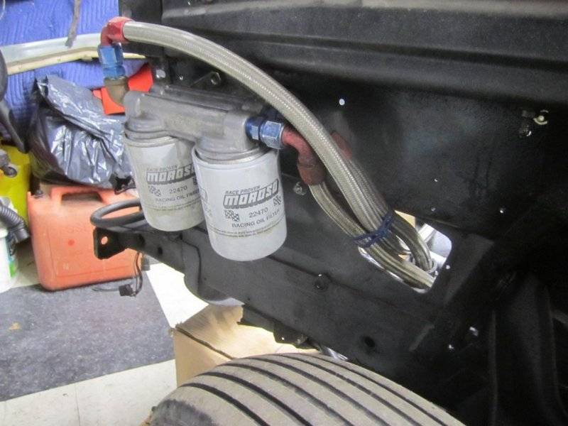

Replaced a dual filter deal and used Moroso NONbypass oil filters.

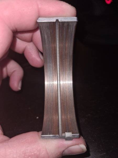

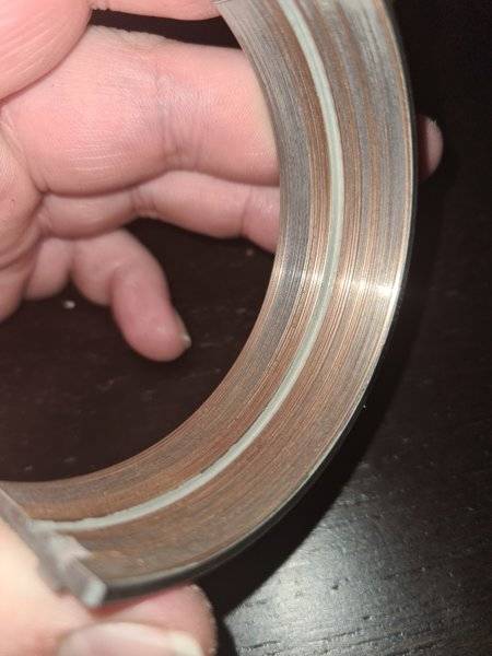

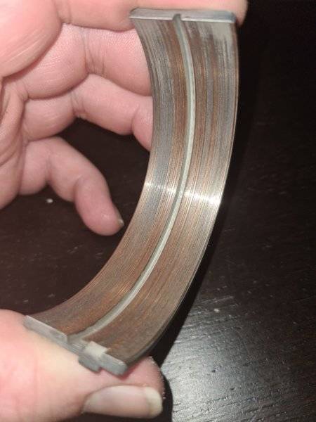

Well, this is just one of the bad mainbearings...... deep grooves and matching peaks on the crank. And on the bottom of the oilpan there was like a grey sludge with something that felt like sand grains......... Something went straight to hell right from the beginning.... at least i know why the oil pressure was bad :elmer::wetting:

Main bearings shot.
