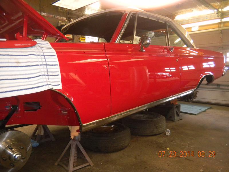

Hello All,The coronet is going together in between summer fun

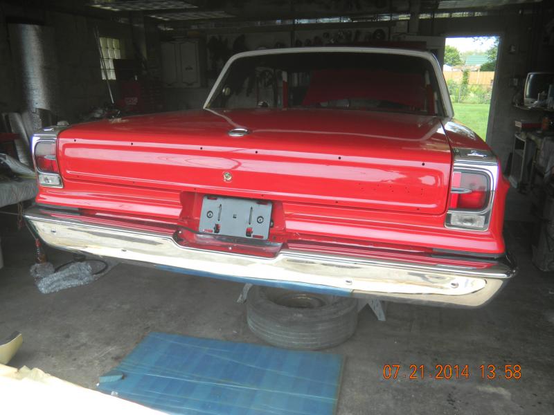

Hello All,I got some more things done.

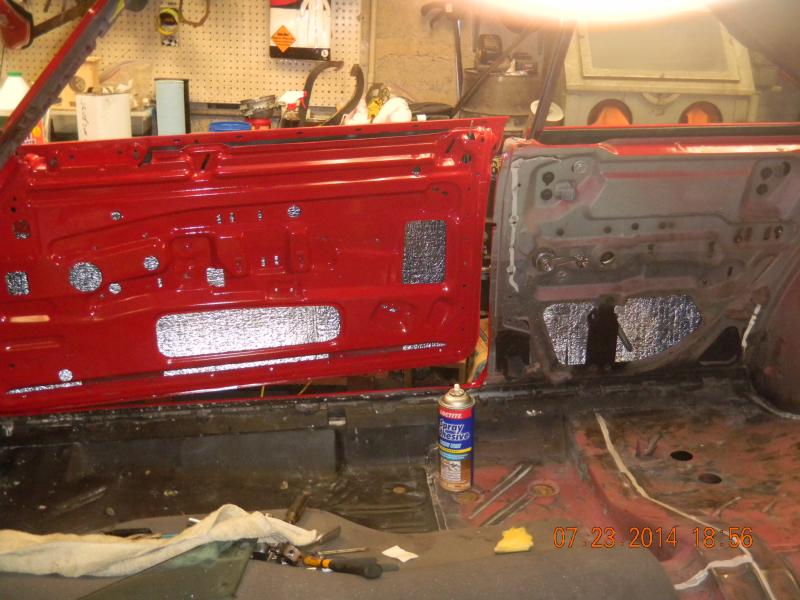

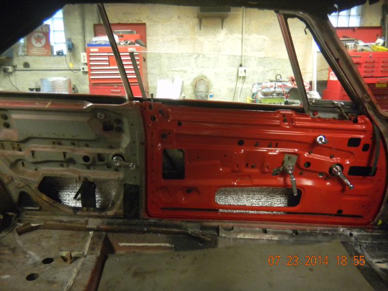

I was a little bored today so we insulated the doors and put the right rear quarter glass in.

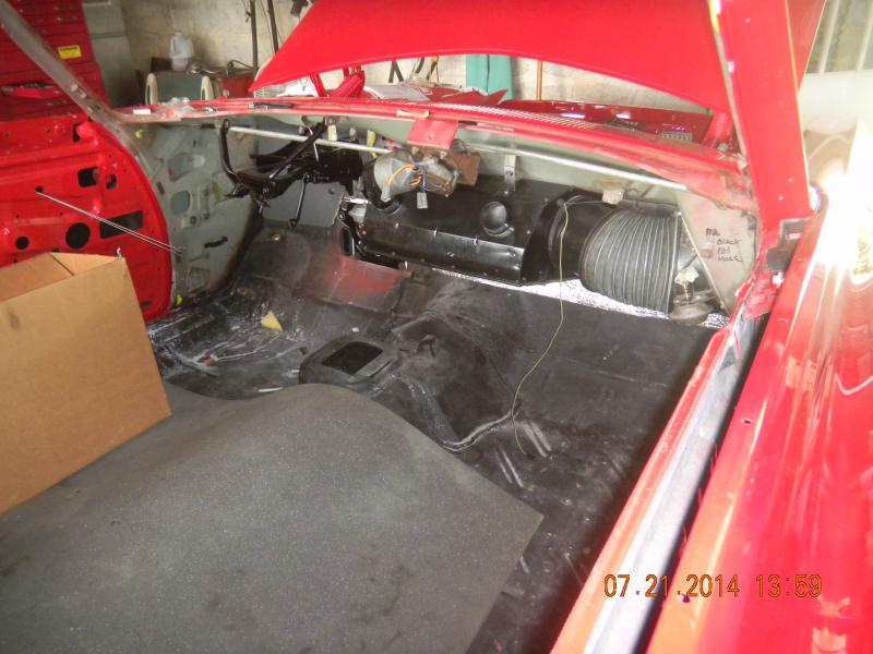

Hi Dave, this is Steve in Maryland. Your project is coming along very nicely and I'm jealous. Lol! I wish I was that far along with my '64 Polara but life and other work just keeps getting in the way.
I noticed your recent pics and the one of your installed heater box in particular caught my eye. Can I ask where you found that large, flexible hose that connects the 2 pieces right in front of the passanger's feet? In my convertible, that piece of hose/ductwork was all but destroyed and I haven't seen them reproduced..... Thanks!
Hey Steve, I may have an good extra one.I'll look and if I have one you are welcome to it. Dave L
