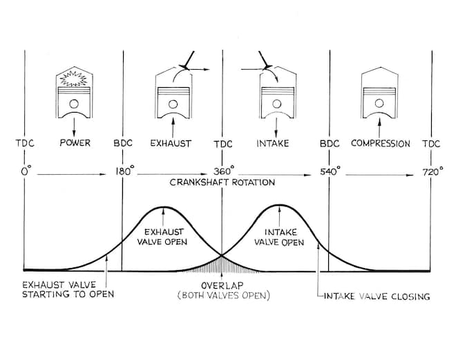

From: https://www.hotrod.com/articles/ccrp-9812-secrets-of-camshaft-power/
Overlap
Duration, lift, and LDA combine to produce an “overlap triangle.” The greater the duration and lift the more overlap area, LDAs remaining equal. Given the same duration, LDA and overlap are inversely proportional: Increased LDA decreases overlap (and vice versa). More overlap decreases low-rpm vacuum and response, but in the midrange overlap improves the signal provided by the fast-moving exhaust to the incoming intake charge. This increased signal typically provides a noticeable engine acceleration improvement.
Less overlap increases efficiency by reducing the amount of raw fuel that escapes through the exhaust, while improving low-end response due to less reversion of the exhaust gases back up the intake port; the result is better idle, a stronger vacuum signal, and improved fuel economy.
Due to the differences in cylinder head, intake, and exhaust configuration, different engine combos are extremely sensitive to the camshaft’s overlap region. Not only is the duration and area of the overlap triangle important but also its overall shape. Much recent progress in cam design has been due to careful tailoring of the shape of the overlap triangle. According to Comp, the most critical engine factors for optimizing overlap include intake system efficiency, exhaust system efficiency, and how well the heads flow from the intake toward the exhaust with both valves slightly open.
