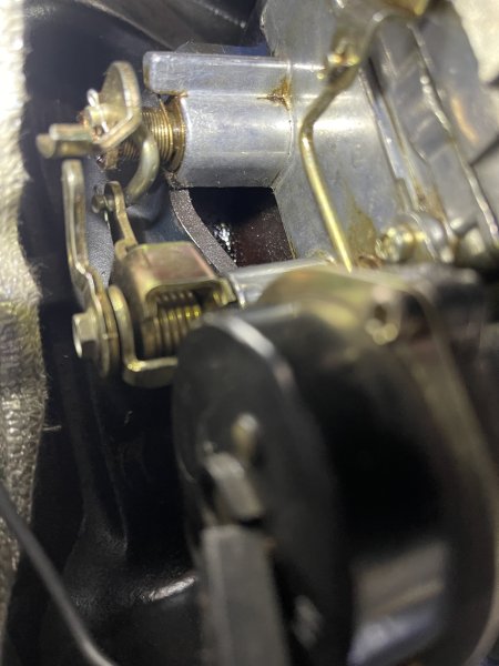

Hey guys - getting the car ready for the year - doing some testing, new alternator, etc.
When motor got to operating temp I noticed some smoke/blow by near the carb base on passenger side - behind and below the electric choke (eddy 1411). Never noticed this blow by before.
Thoughts? Thanks.
If you have a 1970-1972 factory intake or a Mopar M1 dual plane then there is a cup and gasket there that can leak exhaust.
What are the casting numbers from the intake?
2806178 is casting on intake.
Thank you!
I see a cast bowl in the intake below the carb - wonder if some carb cleaner is in there and is just blowing off once it warms up? This seems to be the area in which the smoke is coming from:
Likely just crummy old fuel in there getting burnt off from exhaust heat
