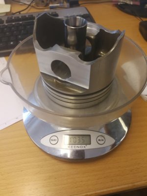

Finally found a set of speed pro l2355 pistons in std bore dimension.
I have lighten the pistons and wrist pins, so they will match the stock low comp pistons weight.
