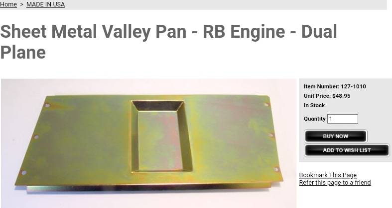

The standard Fel Pro valley pan works well with the RPM heads since they have no heat crossover. If you use the paper Fel Pro gaskets, be sure to use the thin ones. The thick one cause fitment problems. I had oil leakage problems with the Source plate I tried. Went back to the old Fel Pro, no leakage.

I don't think I would run the damper. 440 source has decent prices on there dampers.
Also for the rpm intake this tray looks decent.
http://store.440source.com/Sheet-Metal-Valley-Pan-RB-Engine-Dual-Plane/productinfo/127-1010/
I would not run that, as far as vibration I just assumed you would balance this engine.

As I said, the Source tray I tried leaked, guess I didn't have the patience to spend a lot of time figuring it out, put on a standard Fel Pro metal tray and no leaks. Just my experience.

I'd agree nothing wrong w the stock tray. I've had good luck even reusing then..w a healthy coat of silicone.
