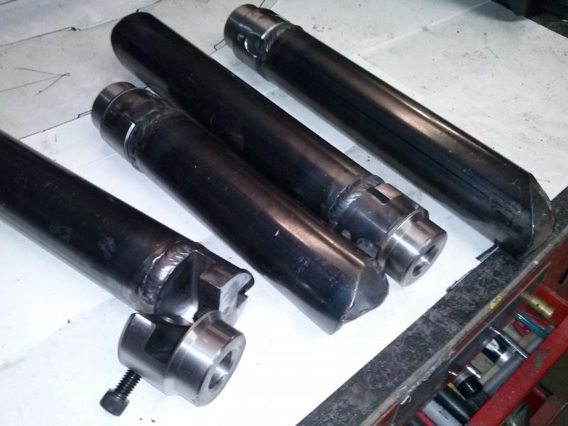

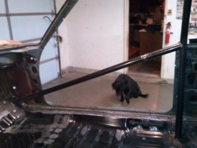

More roll bar work- Got my stub bars done,. these will weld to the main hoop, for the door bars and rear brace bars. The couplers will keep the hoop small enough to come out of the car when unbolted.

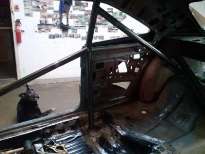

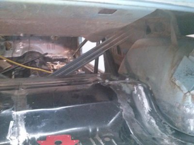

Back to business, I got the rear bars going in. They bolt to the top of the hump in the trunk, right on top of the partial rear rail connection., 1/8 plate on bar foot bolted to 3/16 plate welded to frame with nuts welded under, as are all other connection points. The right side came out very good imo. I found out it's tuff to keep bolt-in stuff aligned that you weld on.
Skip approves.
