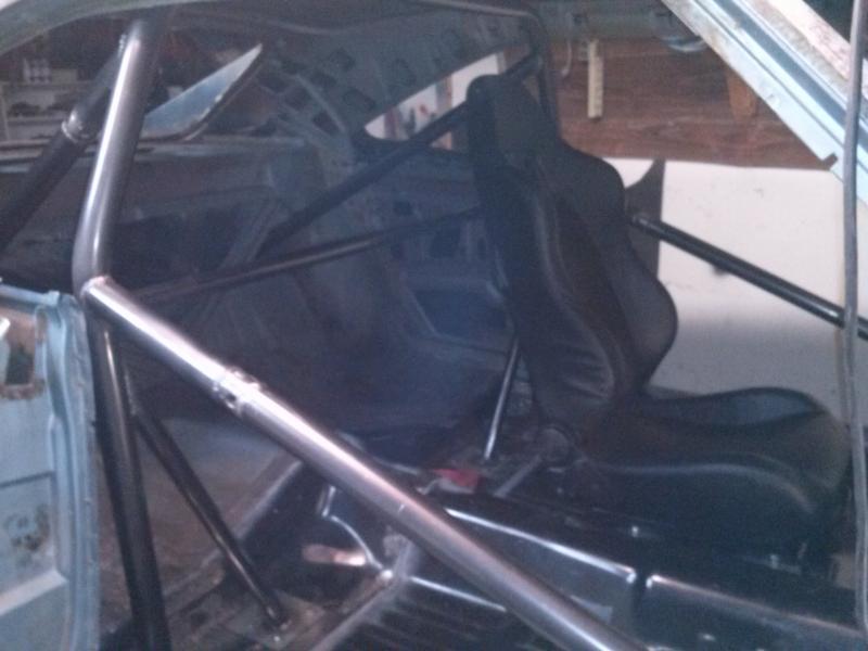

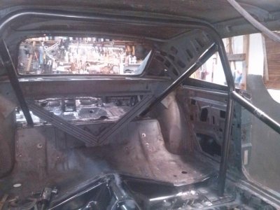

Got all the main bars done.
Great job on the bars - looks very professional.

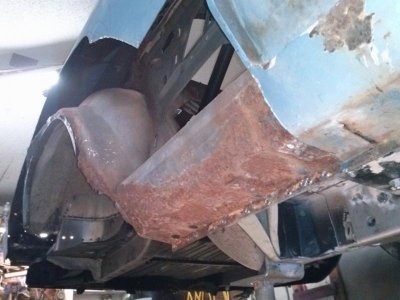

Moving along, slowly,. Back to the right 1/4 skin and wheel house, I cut off most all the bottom front of the old 1/4 while getting ready to do the de-hump mod. I will treat this rusty area after blasting., I think it still has all the strength it should since this is mostly surface rust.. I did not remove or replace this area on the drivers side and now wish I did, but I did blast and rust treat it as much as I could. I guess I can do/redo it later, I still have the piece I cut off of the new skin. This is a hard place to get rust treatment into without opening it up.

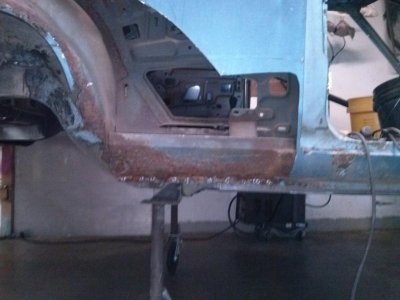

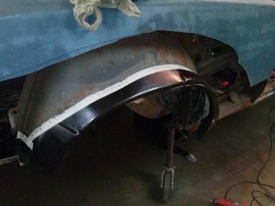

And I have the lip patch for the wheel house just about ready to go on. I guess this side will be mostly a repeat of the other, so forgive me but I like keeping a record of everything I do on the car with this thread.
No need to ask forgiveness. You know how much we like car ****.

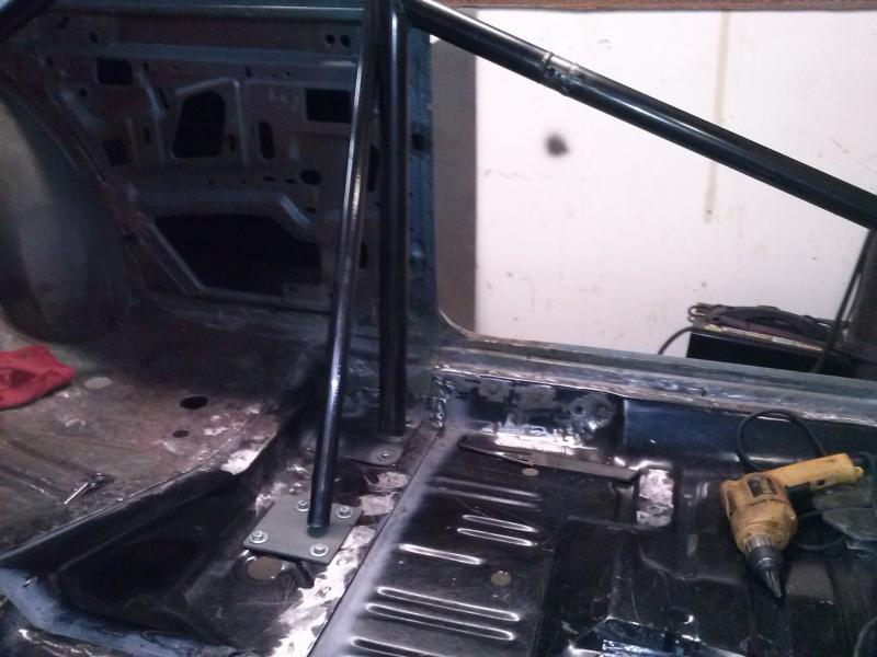

Kinda bouncing back and forth between the fender work and the roll bar. Not much left to finish on the bar tho. Want to go ahead and get that done. This pic is one of the lateral braces that will go on each side. I'm thinking that having the roll bar in and bolted tight that the car will stay straighter during my work, on the rotis especially. But I will loosen all the bolts before installing the engine and have all running weight on the tires, then tighten them when the car is complete. This is the same thought as with the sub frame connecters, which I only spot/tack welded till final running weight.

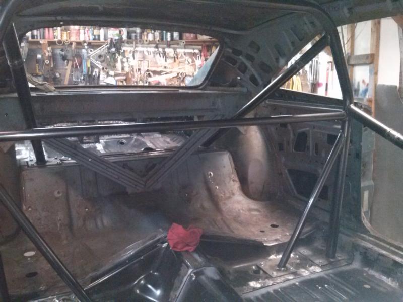

Roll bar install complete. Now back to the right wheel house and 1/4 skin.

That roll bar turned out great! Now I want to put one in my car. :) The only problem with that is I still want my back seat.
