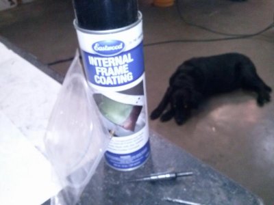

I thought I mentioned previosly what I was using for these tight slightly rusty areas, but I tried to look back and could not find it. This stuff works great but goes quick, the big can will empty in about 20 seconds., but you can get to some really tight spots. I think it is a zinc-chromate type rust killer., like used a lot in aluminum aircraft. Insert the tube, twirl it as you spray and pull it. Nozzle sprays 4 different directions, tube is a couple ft long. And best of all, if you clean the nozzle after you run out of the Eastwood you can use it with $.88 Wallmart paint.

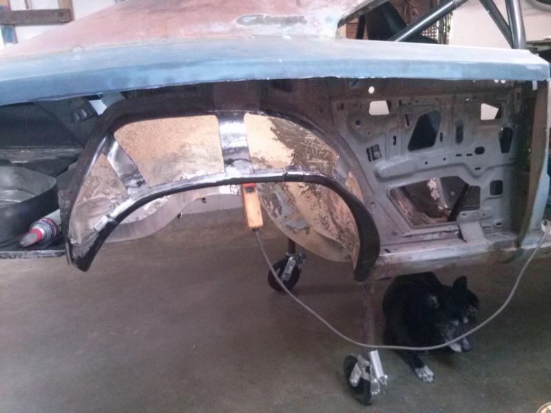

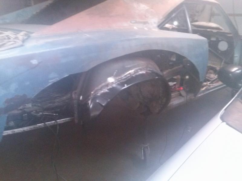

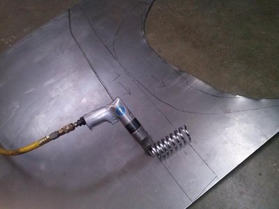

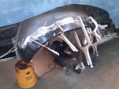

And-- Wheel house/lip patch ready for weld.
