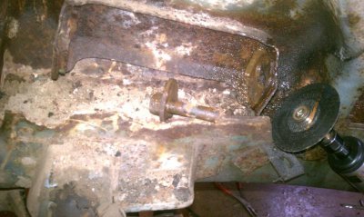

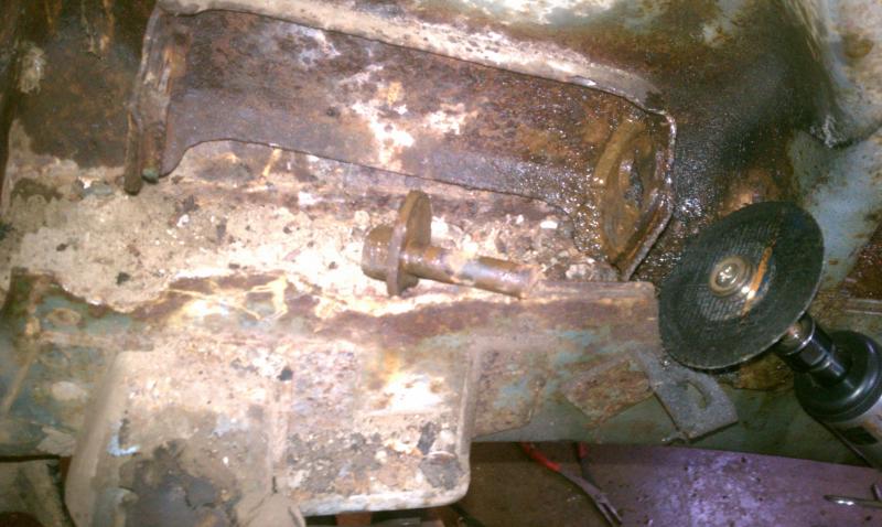

Well, Thanks to that link, I have changed my mind again. After studying those pics I cannot live with my rotted rear rails. I will replace the aft part of them like they did there. It would bug me not to do it right, and "Go the extra mile". I had ordered some rear rail caps/covers, but maybe the co will let me return them.
(Lesson - "Don't rush and buy stuff before you think/study/research hard and long about it.")

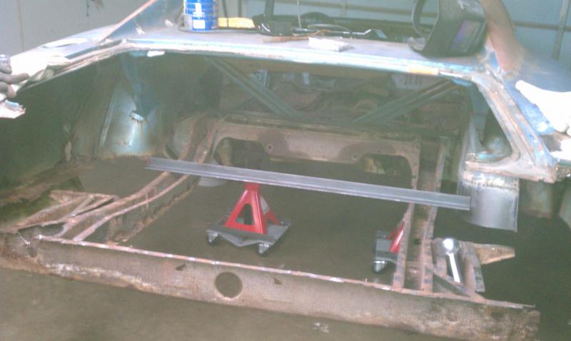

Now I will set the car up for taking off the rails. I will set the jackstands off the rolling dollys and mark the floor around them, take some measurements, etc... I will buy some of those tall support stands to hold the rails up while removing and replacing them. I think I will weld a piece of angle iron across the front/top of the old ones before cutting and leave the rear cross member to hold them together as "unit" for measurement checks, etc.. My shock mount brace is ok so will remove it and reuse.

You're thinking along the right lines...Don't cut corners, do it right the first time and be done with it. In the long run, it's always quicker and cheaper anyways. Besides, those rails are really shot! Good idea on measuring out the original position of the old ones. Maybe cross reference it with a Chrysler chassis chart while you're at it. Progress is looking good!

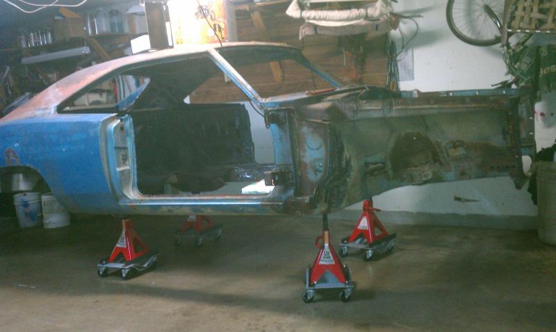

As soon as you remove the k-frame and front end, the car is going to get quite tail heavy. You may want to put another set of braces in the back to compensate for this. I had mine on a hoist and was able to use rachet straps to tie the front end to the hoist. Check out the bracing I used - it worked out very well. I can send you additional pics. if you want.
I thought about that. I am looking for some taller utility stands for the back end. I would also soon like to make a one piece stand/table with some big enough wheels so I can get it on a trailer. Thnx

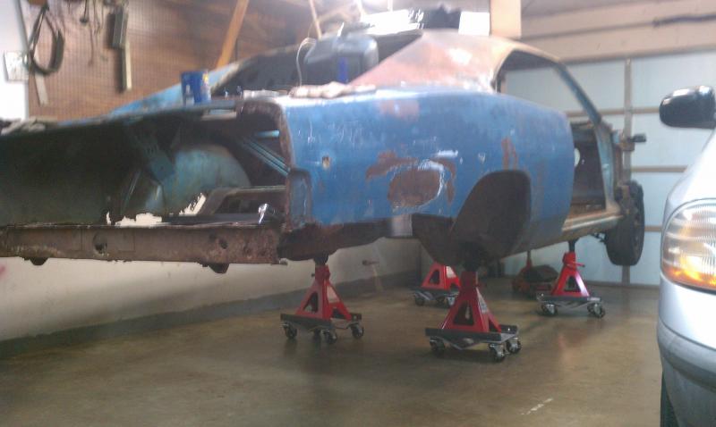

I got all the front end off except the K member and steering box. Will get them in the a.m.. I put my sand bags for blasting in the front cab floor to make sure it stayed on the stands. The rear bolts on both upper A frames were stuck big time, had to cut them to get the A's loose. Funny thing- the torsion bars had fresh looking 45 year old grease in the rear end holders. Sent the rear rail covers I had ordered back today, caught the ups dude and refused them. Will be ordering the partial rails soon. Anyone no of a good source for ordering the partial rear rails? AMD doesn't carry them. I see Sherman has them.

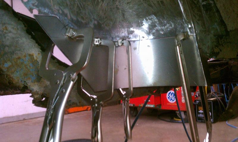

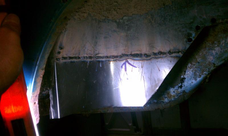

Patched the other wheel well. Managed to actually run beads instead of spots, with no holes. I learned a good lesson on these 1st few sheet-metal patch repairs. "Fit it, weld it, grind it, and then don't mess with it"., don't or try not to weld more after you grind. The metal gets thinner and you burn thru trying to plug holes. I had to remove the 1st well patch I did and cut off up another half inch due the trying to weld up holes after grinding too much. Like trying to weld aluminum foil. Anyway there both done now and the new rear rail partials should be here soon,. So time to get to work on that.
