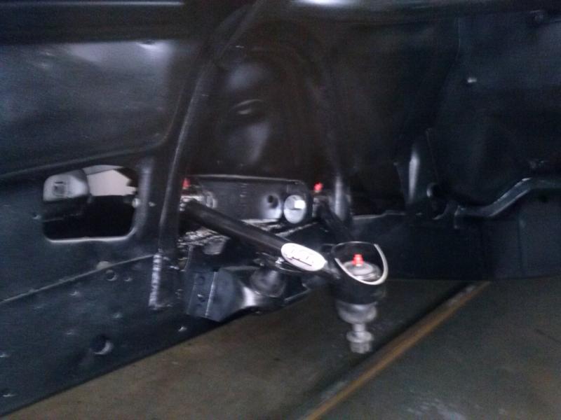

Moving right along, Got the other leaf spring on and one of the upper A-frames.

Man, You sure have this looking like new for sure! Great work!
wow...you really are moving right along. It's a trip going through this thread from square one to this point....Ton's of work done!!! Keep it up!
Thanks Guys..

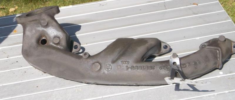

Here's a manifold I just rinsed off after a three day soak. Almost completely rust free..it was crusty and brown to start.

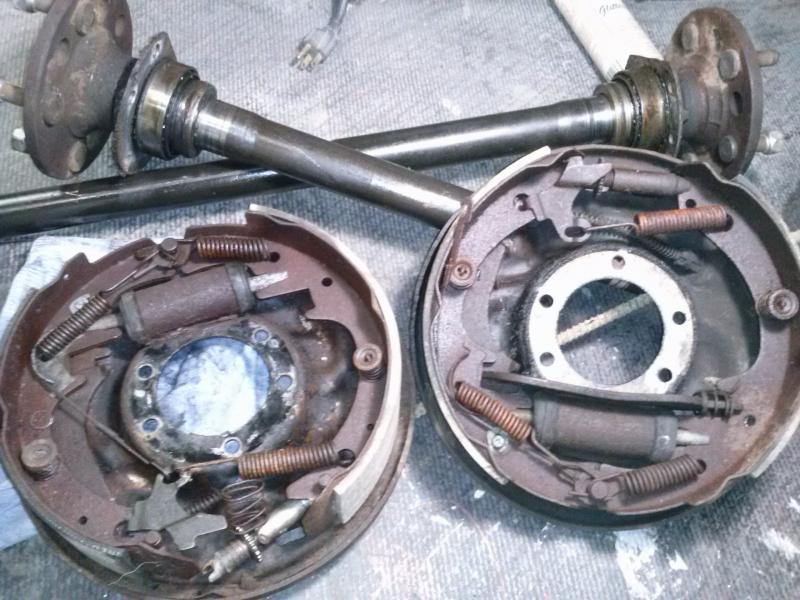

Got the rear-end apart and the brakes off, no surprises. Everything looks pretty good, so far.
How do you get the bearings off the axles? Or should I just leave them, clean them up and regrease? They don't look bad.
