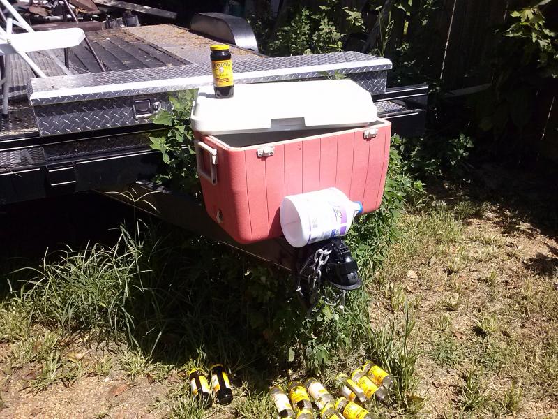

Got my molasses vat set up.. Had trouble finding cheap molasses, got tired of looking, went to local Wall-mart and bought 12- 12oz jars., at $3 each. Added 6 gals of water, stirred it up, and inserted my old lower control arms, strut rods, the small rear brake parts, and a couple other things. I'll check it in a week or so.
I'll never eat molasses again, gag! :icon_puke_r:

I get my molasses in 18KG (40 lb) pails at the feed store for $20 Canadian.
Get yourself a skimmer, or tea strainer to help remove any mold that starts to grow on the surface.
-=Photon440=-
Rgr tht, got one!

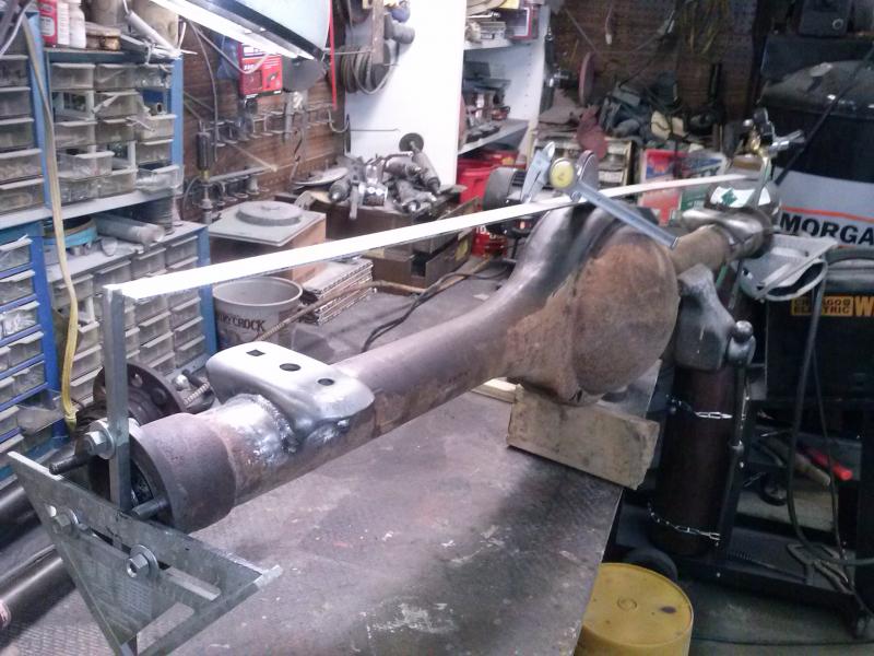

I removed the old perches on the rear end and putting on new ones a little closer together for the off-set hangers and shackles. Very careful measuring here.

That measuring stuff is what always gets to me, i wait and think its right and most of the time im on the mark, but sometimes i go over it so much i sleep about it.. Cant help it sometimes its a done deal.. anything can be repaired or changed but measure twice cut once is
imprinted" on me lol.. Looks good!

I don't want to scare you but when Kahn and I narrowed his axle we were able to keep everything really straight until we welded those perches on, welding them on pulled the axle about an 1/8" on each side. We were able to pull it back with some carefully placed heat from the torches. I could send you the bushings if you can come up with an 1 15/16" shaft so you can check it.
I thought about that before I welded them on, so I did it very slowly, skipped around with 1/2" beads, and used a wet rag to quench after each bead. I think I'm good. Thnx anyway!
I quenched around them not right on the beads, and slowly, so hopefully they won't be too brittle.
Taking a file to the weld will give you a sign of whether or not they are hardened just try it on a known mild piece of steel and compare the difference. If it is hard you can fix it, just heat it up and very slowly cool it back down if your concerned at all. Boy your car is really coming along and looking good.
Thnx, I tried that and the file cuts the welds pretty easy. I think they're good to go.

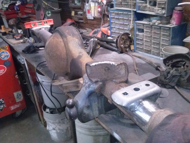

I went ahead and checked the rear-end for warping, just to be sure. I rigged up a couple pieces of key stock to the flanges that stuck out top and bottom, measured between them with a dial indicator and found almost no difference. I'm thinking if it warped that would have showed it. Now I won't worry..
