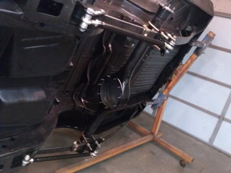

Got the rear end housing cleaned up, painted and installed.. I'll be taking the car out of the rotis soon, it's starting to get to heavy for my comfort. I'll put the K-member in then put it back on the rolling jack-stands. Since most of the hard work on the bottom is done there isn't much need for the rotis anymore.

Wow! That looks really nice Daytona, nothing better than crawling under your car for some wrenching and seeing the bottom just as nice as the top............... Well done. I've got 27" tires on mine, if you want I can take a pic holding a tape measure showing just how much more room you have if you like.

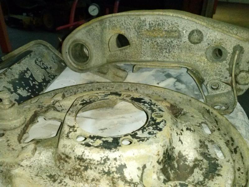

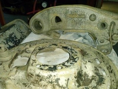

Here are a couple of parts out of the molasses after 18 days. I water rinsed them and blew dry with shop air. There is a little flacky paint left and some minor black pitting that may have gone away with a few more days in the vat. I will now hit them a little with the sand blaster. I will have to say this is working great for me, so far. My small sand blaster is slow and not an easy set-up to use. Using the molasses will cut out probably 80% of the blasting, I would guess. I would highly recommend the molasses to anyone, unless you have a really good working sand-blast cabinet or can get a good deal from someone else to blast stuff for you.
Amazing!
Looks like it took most of it off. I used a harbor freight sand blaster for mine. It worked fairly well and actually the only reasons it wasn't perfect were mine...too small of an air compressor and needs an air dryer.
I also like to use "rust prep" which is an acidic solution that forms a zinc sulphate on the surface changing the chemical composition of the rust and a good base for primer. So far everything I have used it on is holding up well.

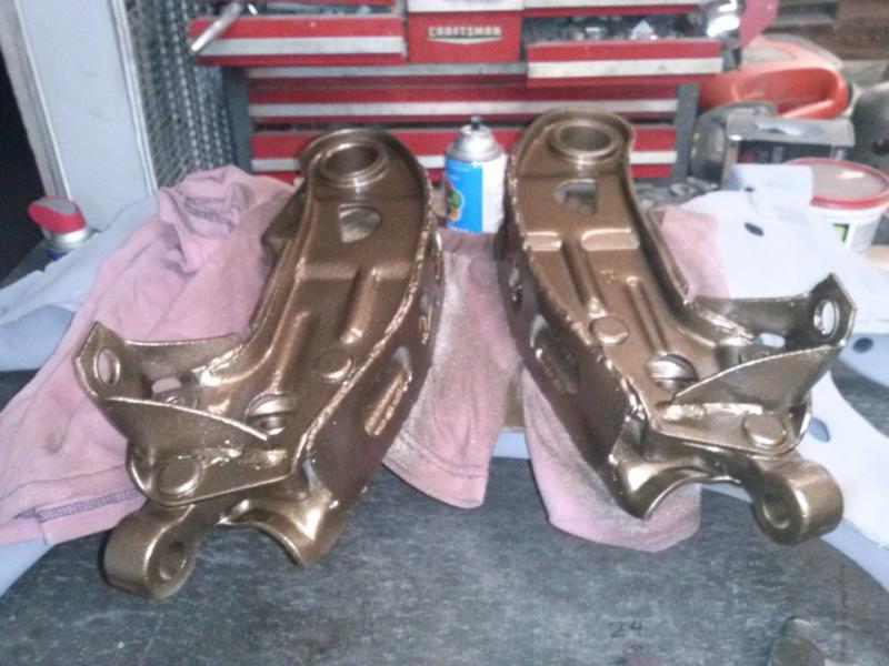

Lightly blasted the control arms, primed and painted them antique brass. Was looking for a color similar to cad plate gold or the cosmoline stuff they had on them from the factory. I'm going to paint some of the suspension parts gun metal gray also. And I'm getting some of that new chrome paint from Eastwood for my roll bars and may put some of that on different things under the car and maybe under the hood if it looks good enough.
