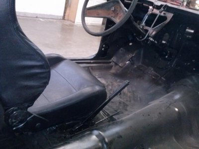

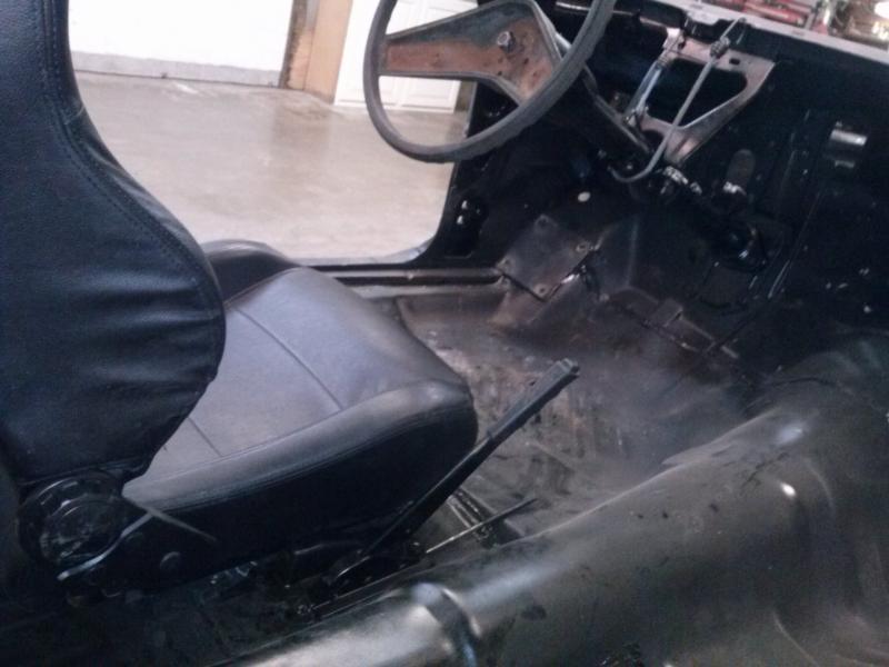

Got the steering column in and feeling good, smooth and no slop. Also took the door bar off, put the seat in and figured out a good spot for the e-brake. I think it will work out good there and be pretty easy to hook up a rod or cable back to the rear cables. It fits perfectly between the 2 seat plates there and will bolt to each of them for strength.

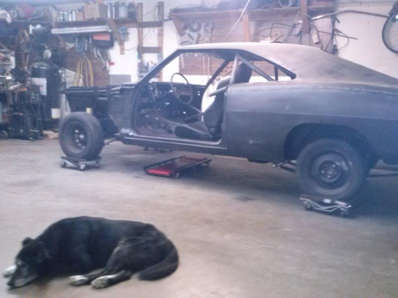

Yea, Interesting thing, Sissy was the thread pic star and always stayed by me, then when she went to doggy heaven a year ago (sob, miss her soooo much) Skip took over duty as my body guard.

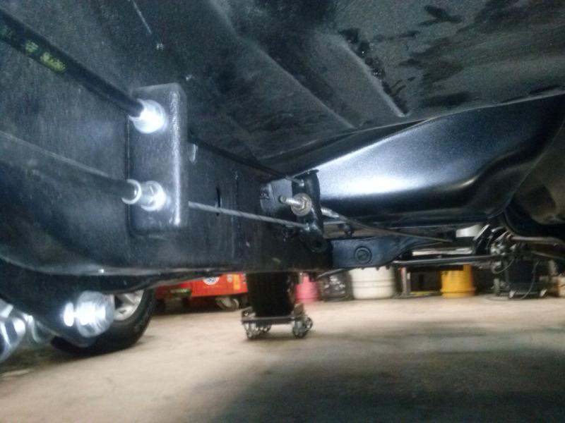

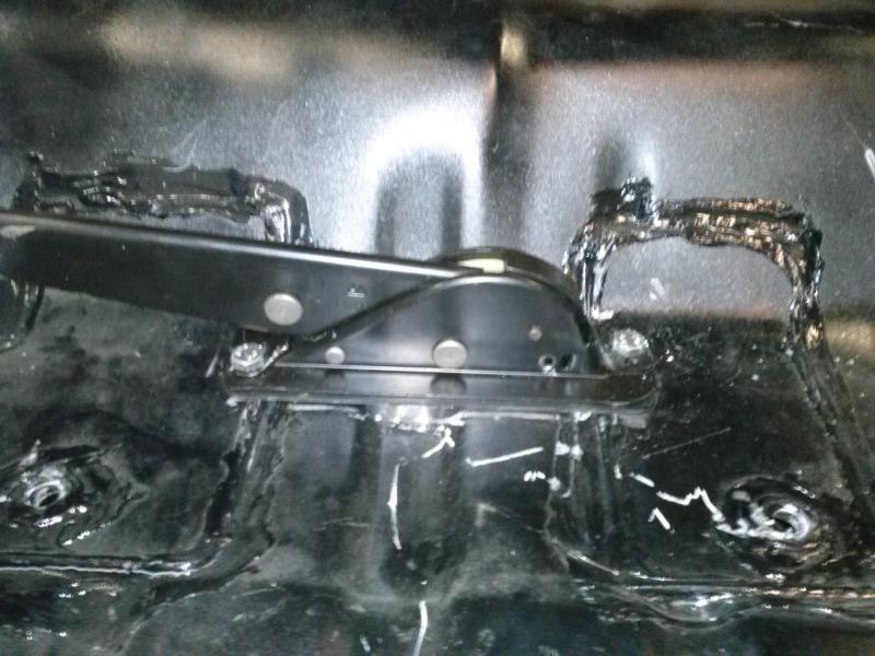

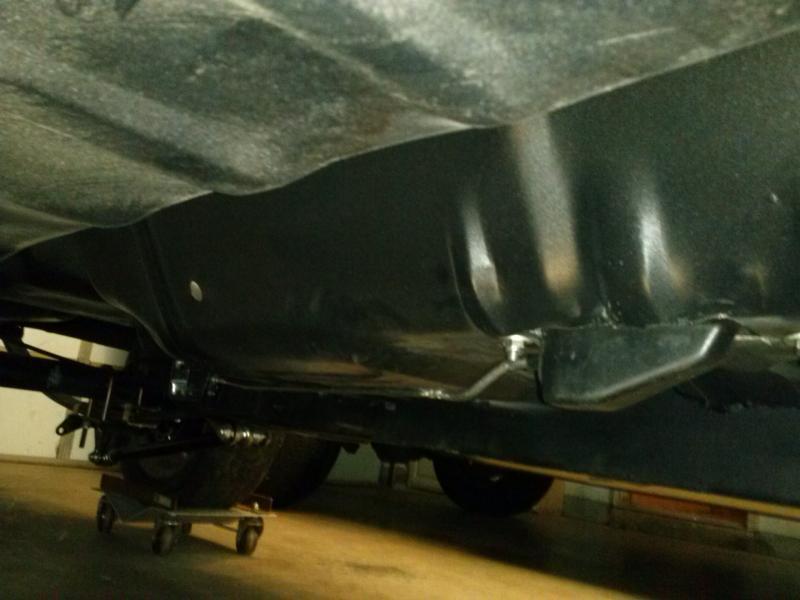

Finished the E brake, works great! I added about 2.5ft of solid 1/4in rod to make it reach the back cables. That handle off the Cherokee was a good find for me since it is a mopar part, even has a mopar emblem stamped on it, sry didn't get a pic of that. Will put some seam sealer around it before the carpet goes in.

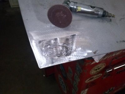

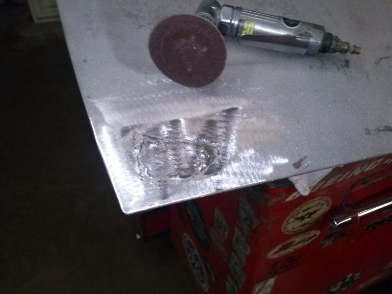

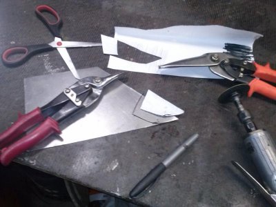

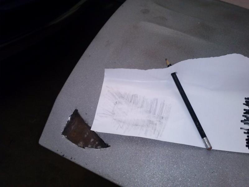

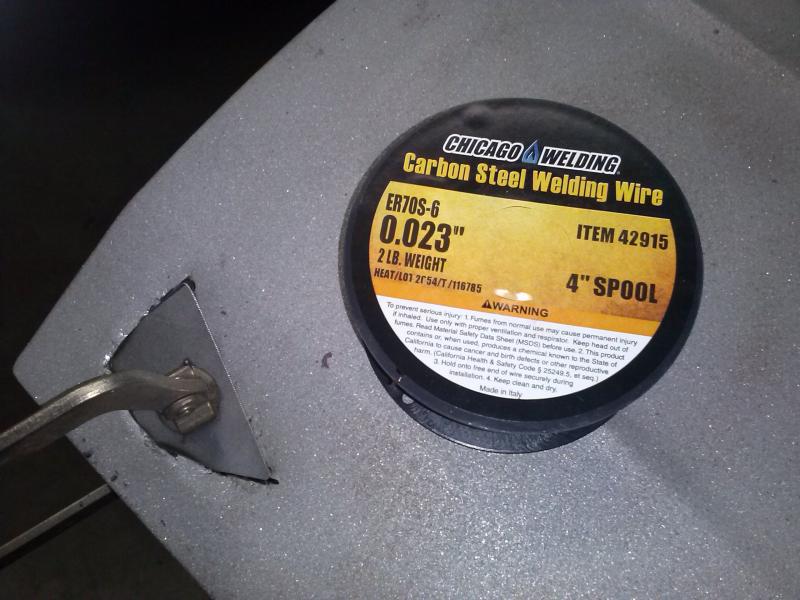

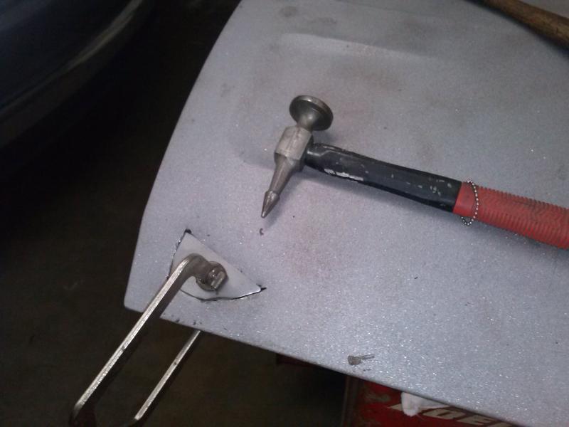

Started getting the doors ready for primer. There are a couple of small rust spots on them that need patching. I tried out a new method (for small patches) of tracing a patch out with paper, transferred it to metal, welded it in and ground it down. A little filler now and it'll be good to go.

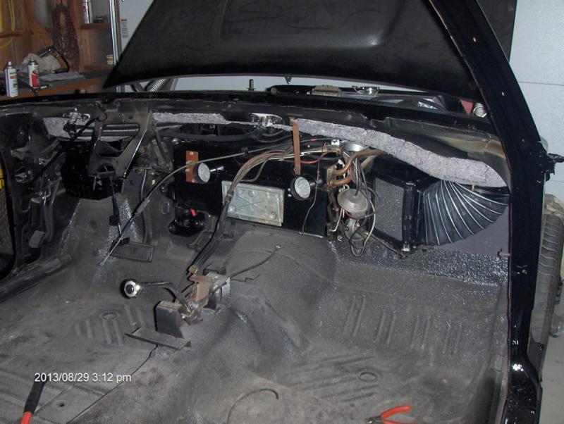

I could use some help guys. I'm trying to get the brake bracket/s, etc. back together under the dash by the steering column. I borrowed this pic from cdr but it isn't close enough. If anyone has some closer pics of that up left under dash area or could take some for me or knows where some are, I sure would be obliged.
