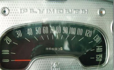

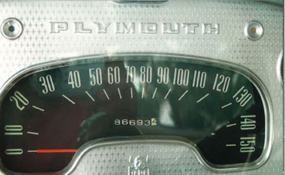

I've been putting up a new fence around my backyard and haven't done much to the car but just about thru with repairs to the 2nd fender. A little prep to the trunk lid and it will be primer time for these last pieces. But to change the subject, but it is a B body, Just got thru watching "Christine" again for the 26th time, one of my favs,,. Never noticed before but there was a close up of the dash and I swear I saw 150mph on the speedo. I never new a 57 Plymouth Fury had 150 on the speedo. Is that true? Any 57 experts out there? Every time I see the movie lately I get the urge to paint my Charger blue and put Cragers on it.

Like this?
Maybe it was an option, or a police part? But the 1958 Christine was no B-body, it had a full body on frame.
Christine is a 58 Plymouth and I saw a 58 at Carlisle with a 150 mph gauge Im pretty sure they came with them
No biggie, Belvedere's were indeed available in the '50's, but the change to being a B-Body didn't happen until 1962.

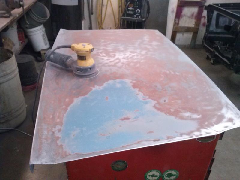

The trunk lid is going to get primer along with the doors and fenders so gota get it ready. That's the last of the old blue paint, kinda sad to see it go.
