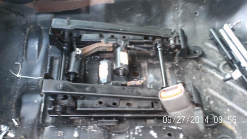

Love doin some update mods to mopars. Jeeps tend to work well as I just put in power seats 2002, power door locks, and like the e-brake thing... nice.. 73 charger power seats goin in.... 001.jpg think i'll try that brake thing.....

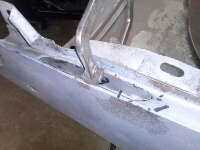

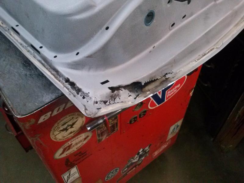

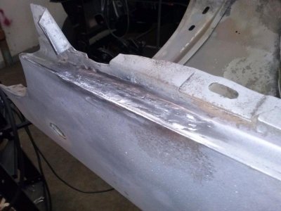

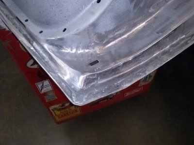

This spot on one of the doors turned out pretty good. There were a few smaller spots that I fixed so now the doors are ready for primer. After the rear window repairs these are not that hard. I'm going to order more of the Eastwood inner frame rust killer and soak the inside bottoms of these doors. I'll start on the front fenders now, not much rust on them but a few small dents. I'm going to prime the doors, fenders, trunk lid and maybe the hood, all at one time after I get everything ready.

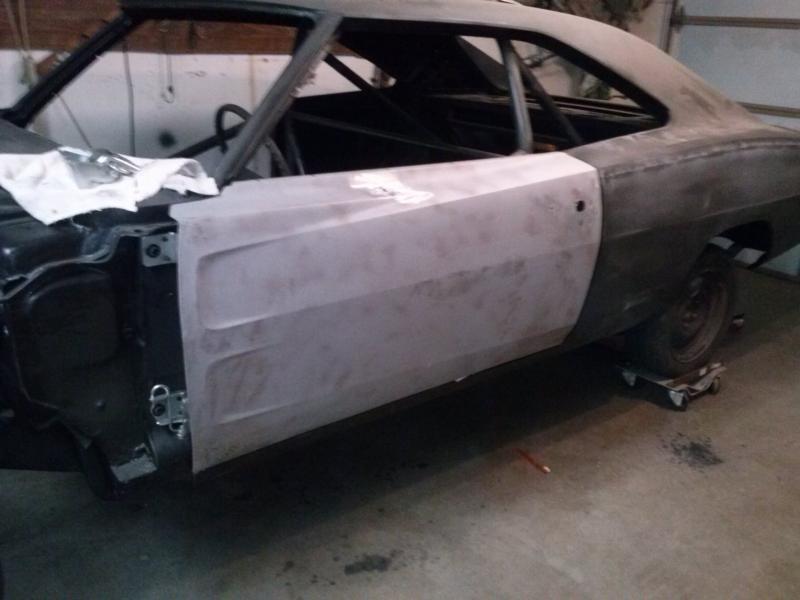

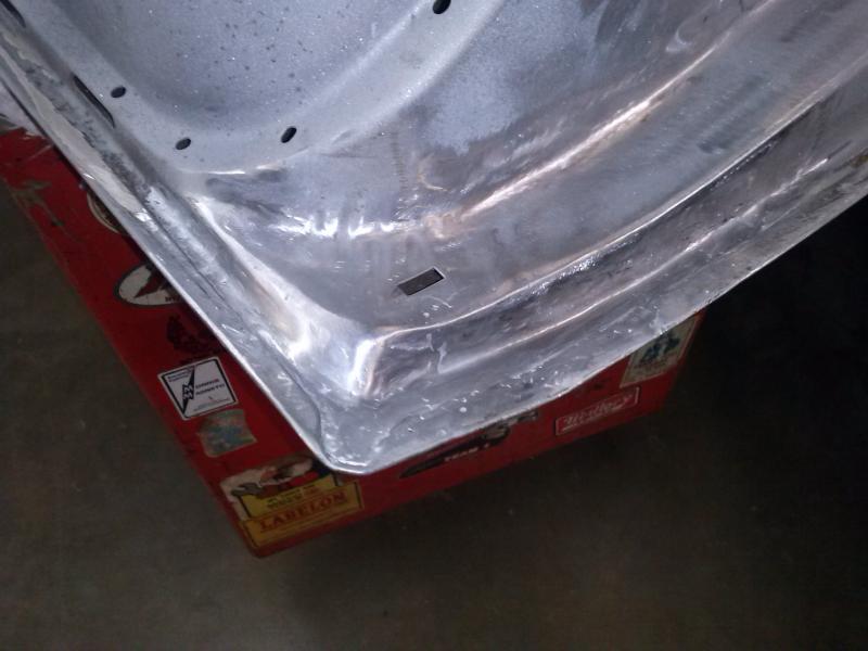

Test fit one of the doors to try out the new hinges, and check the gaps and body lines. Everything looks ok. Not wasting time trying on the other door till after primer.. Now to work on the front fenders.

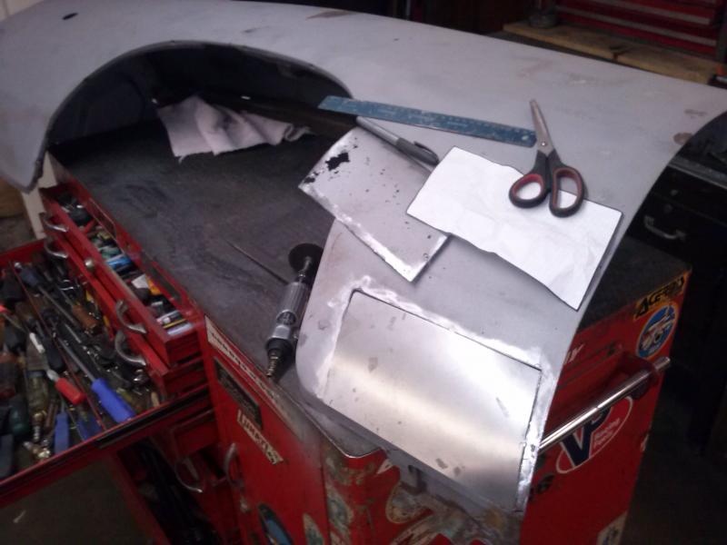

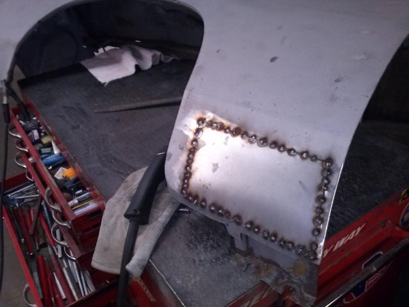

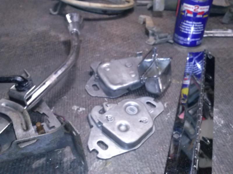

Got a little work done on one of the fenders, played a little connect the dots. There are a few more spots on the fenders but this was probably the largest spot I'll have to patch. And the 4th pic is some stuff out of the molasses, really amazing how good most all of the parts look after a couple of weeks in there, some look like new.

They really do look like new, I did think the process would work reading about it but it looks great! I have done things differently what little things ive done but that looks pretty sweet, no pun really intended but kind of sounds cool.... :)

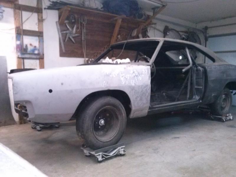

Got the 1st fender ready for primer, one more to go., thought I'd see how it looked in place. Kinda gave me a little motivation boost., shoulda left the door on.

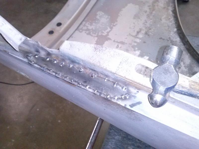

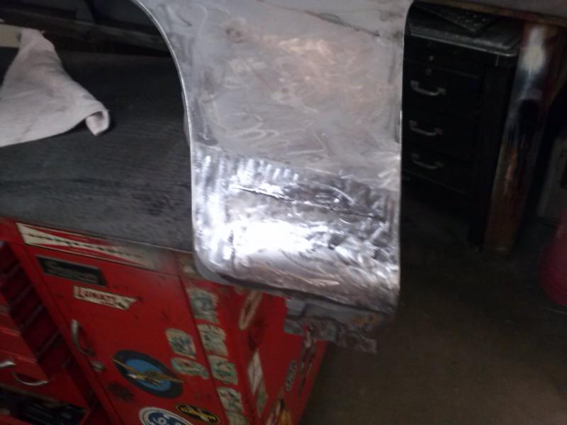

The 2nd fender is going to be a little more work than the 1st. Here is 1st patch on it.
