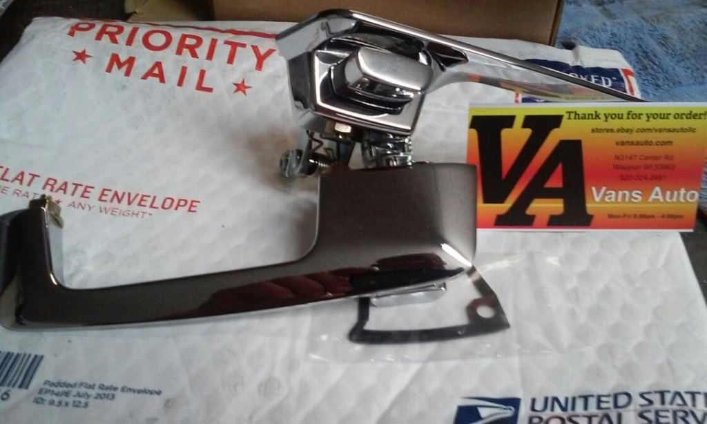

Got these today off ebay, $50 & free shipping. Quality seems fine.

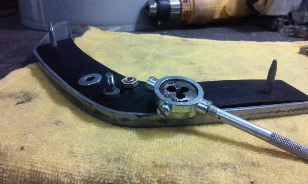

And also figured out a way to fix these quarter extensions when the studs break off.

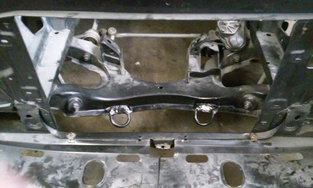

Saving up my money and looking for another body shop to finish the paint. I may start doing a little more of the filling and blocking while waiting tho. Also going to weld some tie down hoops to the K frame soon.
Update- I welded some D rings on the K frame. Yea, they're ugly but hopefully won't be able to be seen much. Same as the ones on the trailer. They may not be pretty but I could lift the whole car off the ground with one of them I'm sure. I sliced notches in the front lip of the K frame and angled them down just a little and welds top and bottom are super strong.
