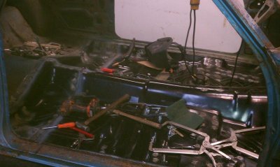

Finally!, I finished installing & welding in the floor pans! That was the most I've sweated since I've been working on the car. The welds aren't super pretty (I'll grind them smooth), but they are super strong and as close to factory placement as could be. It all came together very nice... I have found a method that helped me make the pans fit perfect. I use sheet metal screws where I can't get a clamp. And I use the weld and tap, weld and tap method. For anyone doing an interior floor or trunk floor with welds like the factory, this method works great, but I spent weeks prepping for just the interior floor. I bet I had it in and out 5 times just test fitting and tweaking., a couple different size ball peen hammers were used a lot before, during, and in between spot welds. I can honestly say that this floor is perfect, not a single gap anywhere and every weld is strong and located exactly where it should be. And easily removable main roll bar mounts.
WARNING> All sheetmetal is sharp and the floor is a big heavy piece, hard to handle for 1 person... I used my big thick welding gloves when handling and moving it.
I am stoked...:headbang:
Time for an "Old Millwater"!

Floor looks good sitting in there. All your thinking and trial/error test fitting has paid off.
Thanks RR.
Looking back, I guess I was more worried about it than I should have been. It was the "fear of the unknown", a job I have never done. Now I can say it was a piece of cake. Those pans had sat around here in the way since November.

Been down that road myself as we all have. Still learning new things on mine.

There's the magic words right there! It's not rocket science...a guy just needs to roll up his sleeves, put in the work and get it done like you did. Good work!!
Looking good Kid. We used the weld and tap method also on the floor and trunk pans. If you blast the area afterwards, the spot will pretty much disappear. Saves a lot of finish grinding, sanding, and filling time.

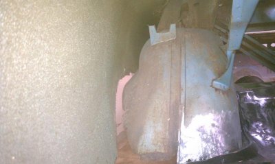

Back to the new toy/project.. I'm preparing to replace the side quarter skins, and I have to repair the outer wheel well halves where they are rusted out. I don't really want to replace them since that looks pretty hard, and I think I can patch them to look decent and hide the welds with undercoating. A bud told me that while I am at it I should modify the outer half of the wells to remove the "hump" for better big tire clearance. I kinda like the idea of "dehumping" since I am probably going with some big tires but don't want the car's rear to high. I think the hump is there for strength but I bet it want lose much if I do it right.
What do you guys think about the dehumping?

It makes me think that you guys don't approve of the de-humping mod since nobody said anything. Don't worry about hurting my feelings, give me your opinions,. I can take it.. If there is a good enough reason not to do it I might not..
