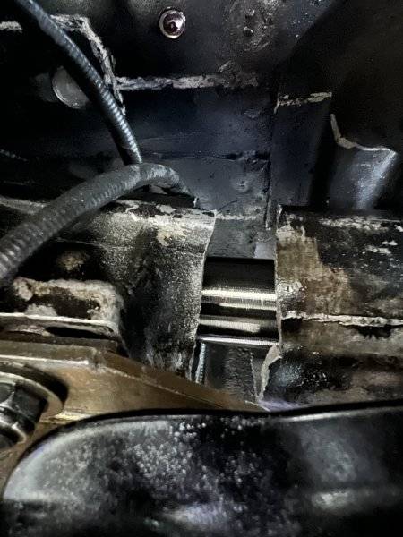

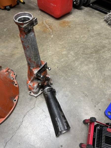

Tough break on the tail shaft housing and yep, that’s the second one. Some limiters will fix that up. Overall it sure was a good weekend though, excellent weather and all. See you next year Wooks!

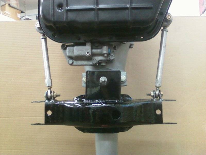

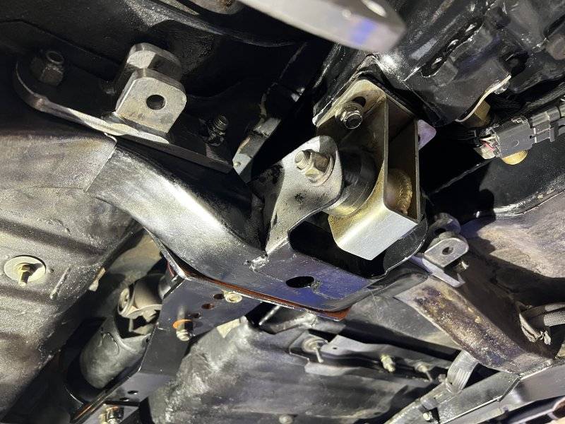

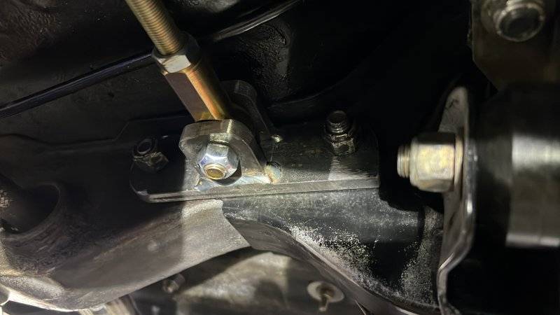

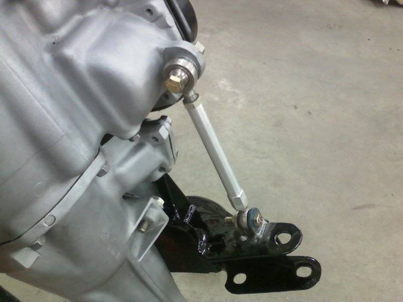

Limiters limit fore/aft movement when using a motor plate. Motor plates don't have great fore aft strength. The trans mount alone can stress the tail shaft housing. Mine has struts from the trans crossmember to the trans case. A strut from the boss on the lower front right side of the block to the K frame works well also. The boss on my block had been removed. Mine has used the same housing since 2013, 850 passes.
Doug

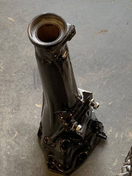

Are they thicker?Couldn't find a truck housing?
Yes, they are an HD version. I put one on the polara after cracking it, and have done several others. The only problem is they don't have the mounts for the console shift rod, but that shouldn't affect you. The snap ring cover is on the side instead of the bottom.Are they thicker?
Ok. If you hear of one, let me know. Trans is coming out this winter. This is a trash fest so I can hit the track once more this year.Yes, they are an HD version. I put one on the polara after cracking it, and have done several others. The only problem is they don't have the mounts for the console shift rod, but that shouldn't affect you. The snap ring cover is on the side instead of the bottom.
You bet. I have 1 trans that came out of a truck,, but I see it must have been out of a car originallyOk. If you hear of one, let me know. Trans is coming out this winter. This is a trash fest so I can hit the track once more this year.
