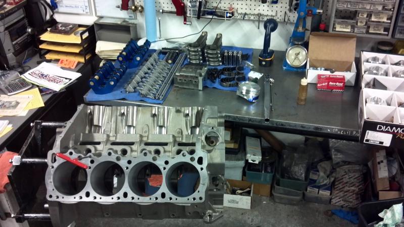

Assembly has finally begun.
Notice the T wrench in the oil feed for the top end. On the Mopar Performance block, this is threaded and has the restrictors screwed in. The MP block feeds top end oil from the lifter circuit, not the cam bearing. For this reason, the cam does not need a groove.
I will not be using the restrictors at this location.... I machine the rocker stands for the restrictors. This does a couple things.
First; if I want to add or reduce the amount of top end oil, I only need to pull the shafts forward and remove the one stand on each side, not the whole head.
Second; I can adjust the amount of oil to the intake and exhaust shafts individually by changing the restrictor oriface size.
Because of the situation with the hydraulic roller lifters height differences and the lack of a bushed type roller wheel, we have decided on a solid roller. It will be a custom grind, and we will use the Isky EZ roll Max lifters.

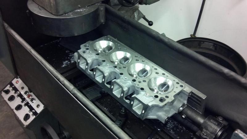

Finally back on track with this project as some parts are rolling in. I decided to go with the standard height ext. ports as they are well up to the job.
I have posted some pictures of the Stage V head compared to the OEM Hemi head on my FB page. I have not measured the port differences in volume yet, but lets just say they are big, and have plenty of material to go bigger.
The porting on the guide boss areas is next, then I will install guides and finish the seats and the rest of the port work.

Wow that's HUGE. For the street? That's gonna be one insanely fun ride. I wan ryd?

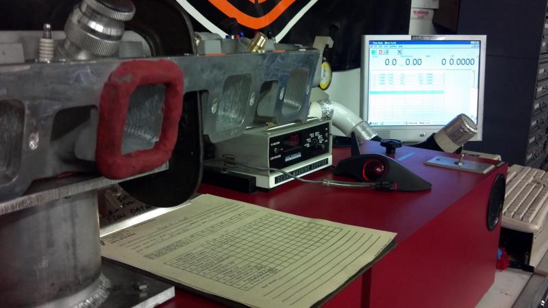

Initial flow figures on the heads.
2.3" intake 1.9" exhaust

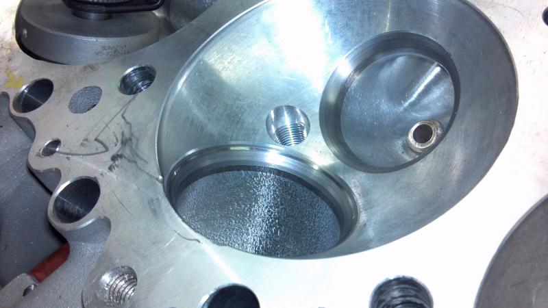

Custom 4 angle intake and radius exhaust.
No burn through on the intake ports, but there was slight deflection on 4 of them. I will be installing tubes
Lift Intake Exhaust
.200" 152 127
.300" 237 196
.400" 320 247
.500" 382 286
.600" 410 299
.650" 414 302
Tested on a Superflow 600 bench.
Final flow testing after an adjustment
Resurfacing for MLS gasket. Just need to final volume check and assemble.

I look at that chamber and wonder if twin plugs would benefit this build. Even with the small dome piston, the bore size being pretty large may like the twin plug.
