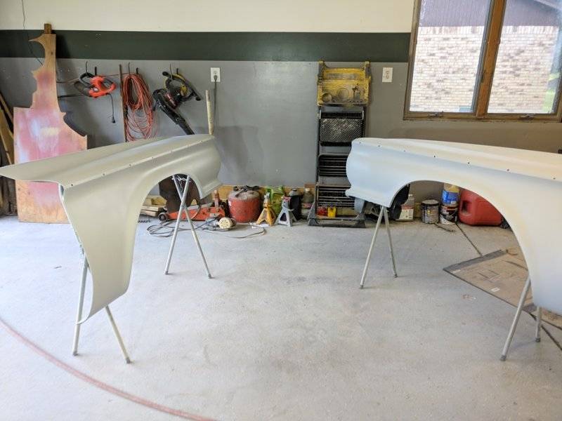

Fenders ready for paint.. will 400 them one last time then shoot, waiting for some more paint to show up though

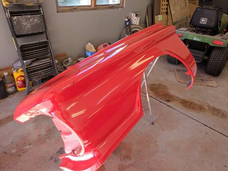

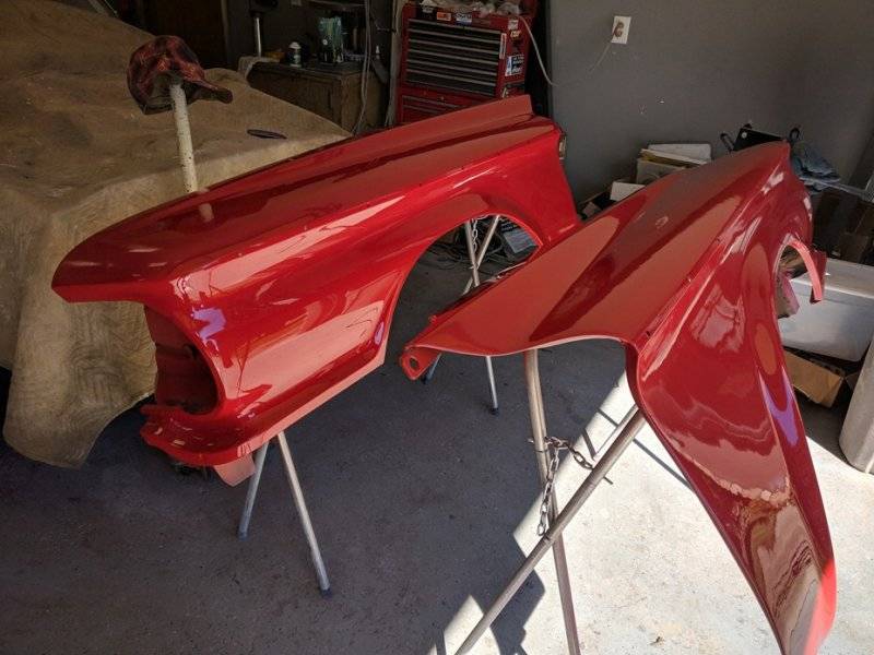

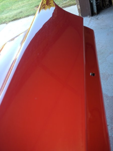

Finally painted my fenders.. spent a month working on them (weekends and such) thought i had them straight and smooth... and they look like a bag of walnuts. Really mad bout that but it fits my MO...

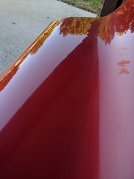

Knocked down the orange peel last night and wish i had left it, not the bad **** stands out more. But.. they are good enough for a beater. I will never know how bodyguys make **** straight..
And after using a denim pad/leveling compound

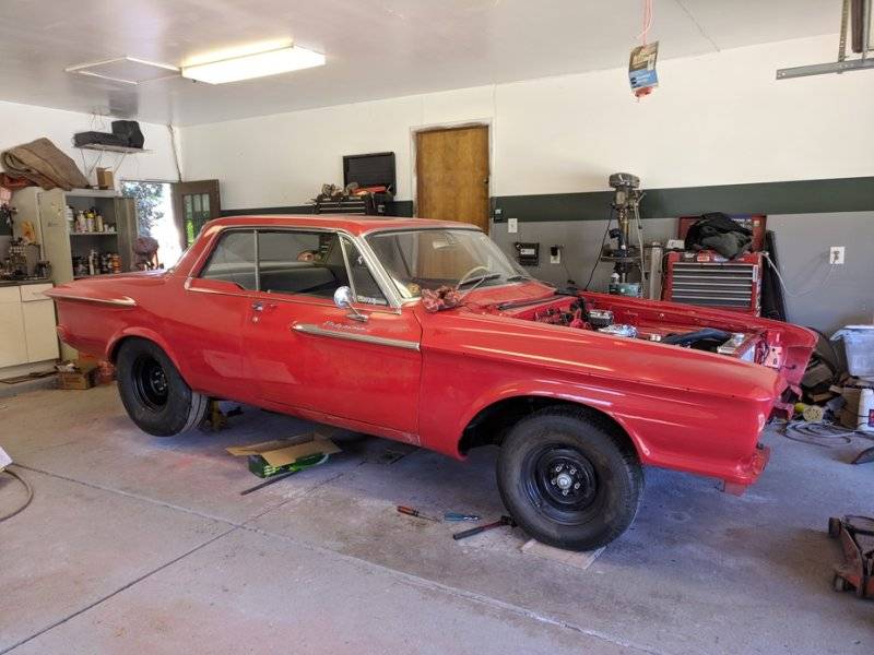

Today i learned a big lesson about pre-fitting body panels.. fenders looked perfect off the car... put them on and the passenger one got bent at somtime in the past and the bodyline was 1/2 high and out... i got it close but it will never be right.. will have to keep a eye out for fenders. These ones came from one of those AZ junkyards.. no rust but not good..

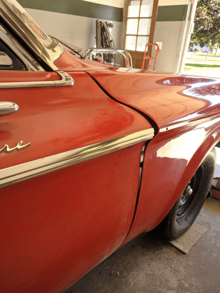

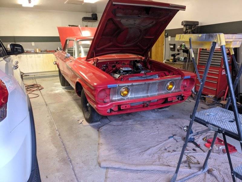

soo.. fun continues.... Went to put my grill in tonight and nothing fits... i took a tape measure and my width from fender to fender (hood opening edge) is 1/2" too narrow for my hood.. and i beleive it's my passenger fender since the gap for the grill is too tight on that side. Just unreal... I don't get how a fender can be this damaged without it showing on the skin..
When i first mounted the fender it was bent up and out at the bodyline in the back, i got it much better.. but not perfect..
This is a pic of how bad it was, i literally bounced my fat *** off the top and got it back down where it's supposed to be. rear spacing seems fine (checked with tape measure and measured hood)
So... either i shim out the front a lot which i have never seen on a mopar.. or i take the fender off and try to bash the inner mount (where the 4 bolts go down the inner fender at the front ) and try to bring it out some.. I had to shim it but if i take that fender off it's gonna go badly. Kramer has a fender that would be like $700 with shipping that is in "OK" shape..
Soo.. just venting... my sister is going to come over one day soon to help me put the hood on, i will align it with the cowl then i can actually see what's going on with the fenders. I'm the it's the passenger one though since th grille is too tight on that side also.
Whats funny is the skin of the fender looked near perfect, it must have gotten crushed in shipping or something to bend the mount..
Yeah, looks like it got squished some.
Yeah... i got the body line almost perfect but that front pinch i don't know what i'm gonna do yet.. replacement fenders are crazy expensive if you find them, and no telling what you will get since this was one. If i shim it, it will work but, i will know....

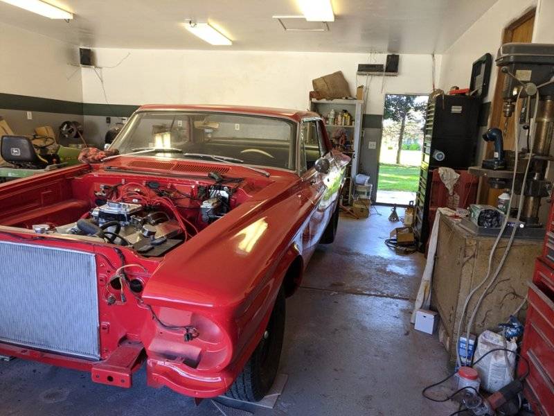

Few more hours and i'm ready for a test drive.. still need insurance and plates though... Am praying the trans actually starts out in 1st.. on jackstands it seems to be starting in 2nd then to 3rd, unless i manually start in 1st.. BUT.. i also am not spinning it up much on jackstands.. so time will tell :)

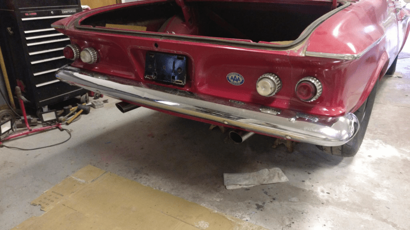

Rear bumper on (chrome is trashed) and putting the front end together turned into a giant pain.. nothing lines up but it's getting there..

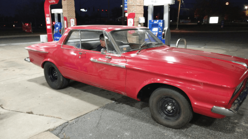

Sooo... 48 years and it finally drove :) Brakes... horrible, gonna order performance pads for it.. they "work" but i should be able to lock them and no chance, all brand new slider manual discs/drums
Thinking a front end alignment is "probably close enough" NOPE.... gonna have to fix that.. need some turn plates. It was white knuckle..
Trans actually works, that surprises me :) 3 forward, 1 backwards just like it's supposed to..
The 4.57s... fuckin hell.. those won't be in long.. will end up trying to trade this pig for a 3.55 or something or just change gears.. 40 feels like 80.. even with the 30" tires.
Built the car i knew i would hate :) nothing i can't reverse later though.. nice mellow cam, 2.89 gears and factory tires/hubcaps one day.. but fun for now
P.S. HUGE smile though... it's been 27 years or so since i drove a old beater.. i didn't realize how much i missed it :)
