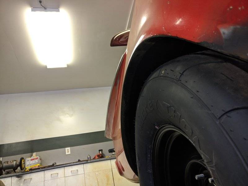

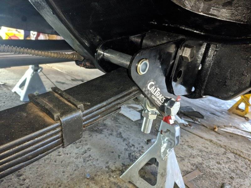

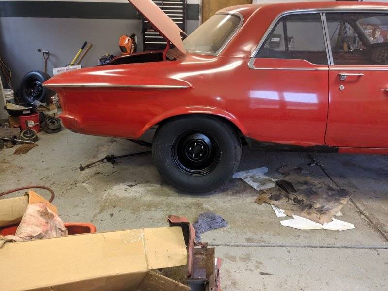

K... some warm weather (60 in michigan in mid feb? no no... everything is fine...) got my *** wanting to start working again.. Got my tires/rims mounted i'm gonna need to move the front of my springs in, gonna do it how DWV does and move the front hanger right against the frame rail that SHOULD get me bout 3/8" between the spring and tire.. Also just ordered caltracs and need to get some perches... so.... soon...
I think i can lower the car bout 1" hoping a little more, really don't want a 70s stance but i need the big diameter tires for now.. (i really should have changed gears to like 3.55 BUT.. i mean... 4.57 makes people smile) :)

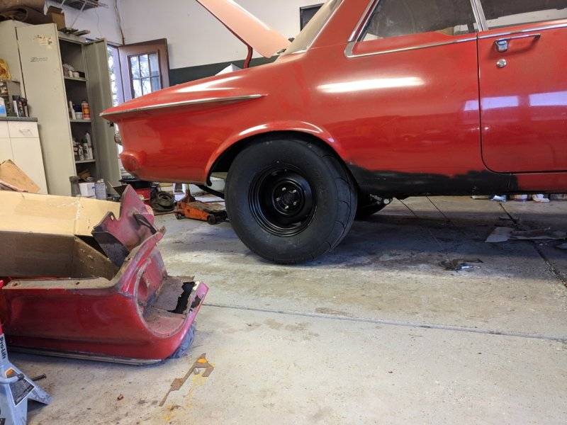

K, finally got off my ***, moved the springs in bout 3/4 inch so the new tires will fit, they barely clear but they do clear :) i'm tired and sore.. I wanna lower it bout 1" still though
Not sure if i like it or not... next job is to get the motor fired up and fix leaks (expecting trans leaks)
I 'lowered' my 62 by installing the 2 bolt hole front spring mounts and mounting the spring in the upper hole.
Not sure if that is an option with the springs moved.
I actually used those mounts when i moved the springs and also moved them up about 3/8 of a inch higher than the stock holes.. I'm gonna wait and see how clearance is after i drive it a bit then add 1" lower blocks if i think i need to, i just dont wan't a stinkbug stance

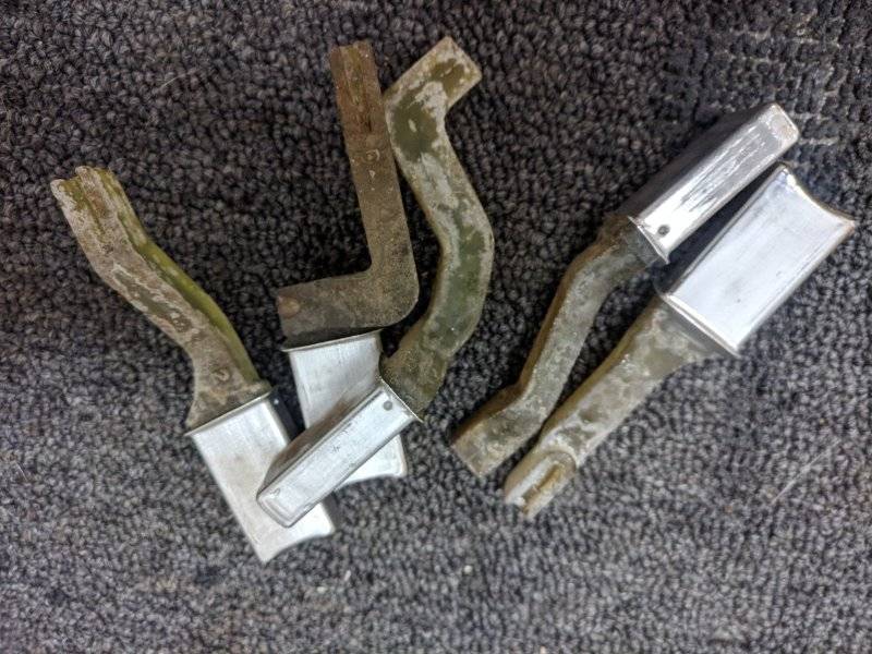

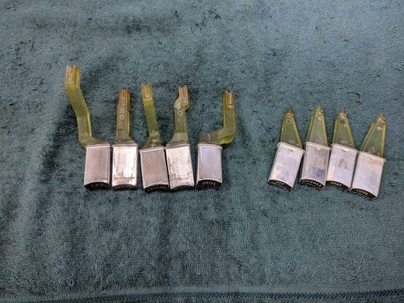

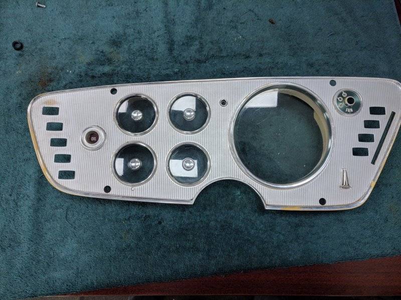

K.. a bit done.. car is back together and starts up/runs good.. started making the exhaust, doing 3" out the back with Gibson MWA mufflers which are 2 weeks out still.. can't wait to have mufflers. Took apart the dash to get all lights working, and the dome light works :)
These were all crusty and no light was getting through, cleaned em up

Would like to fix the chrome/silver on this.. but would make it worse.. gonna leave it

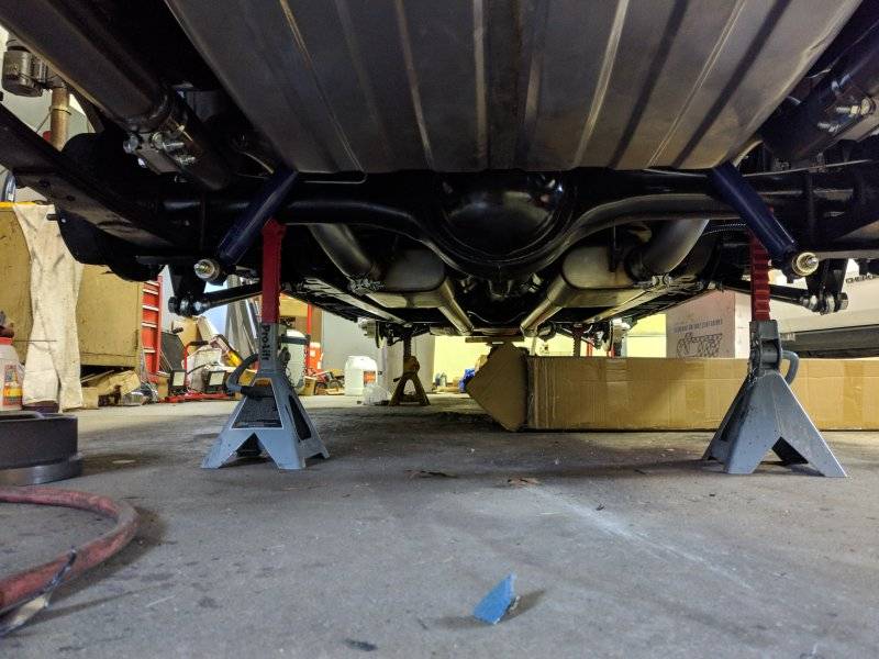

K.. 3 weeks later and i finally did the exhaust today 3" out the back with Gibson MWA Mufflers.. it's too loud but i will survive, this is the first exhaust i made myself and i'm pretty happy with it (other than a header leak on cyl 7) sorry bout the bad sound.. too loud in the garage for the phone to handle still

Ended up cutting out the spring perches tonight, pinion angle was WAY off and i had a bad vibration, also want to center the rear end better, it was 1/4" to the passenger side a tiny bit more tire clearance on the drivers will be nice
