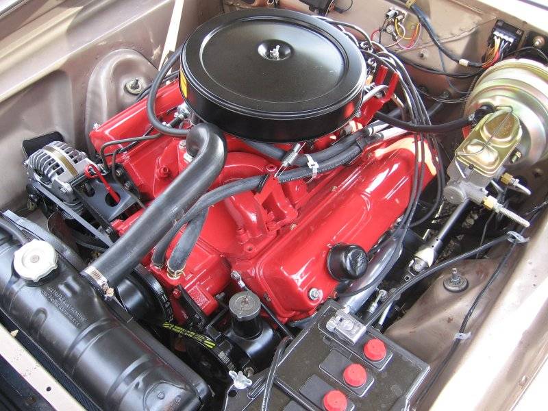

Beautiful engine :) At this point i am leaning to finding a 360 and either heads/cam rebuild or 408 stroker.. i have the money i just hate spending money :) Growing up broke messes with your head forever.

I'm on my 3rd 63 and had a 64 and 65. Your sludge was and is very common on those engines because of the type of oil they used back then.
I remember pulling valve covers on a Poly 318 way back in 1973 and a quart of oil dumped out of each ! The oil drain back holes were sludged over.
The car came in with a flickering oil light.Reamed the holes out with coat hangers ran the valves and sent it on it's way. Dang thing ran like a clock.
Just food for thought you can make the Poly 318 really run. The photo I will post is a 390 stroker that we did from the stock 318 in a 64 Dodge.
Nothing wrong with any way you go,383,Small block LA or Magnum,what ever you budget allows.

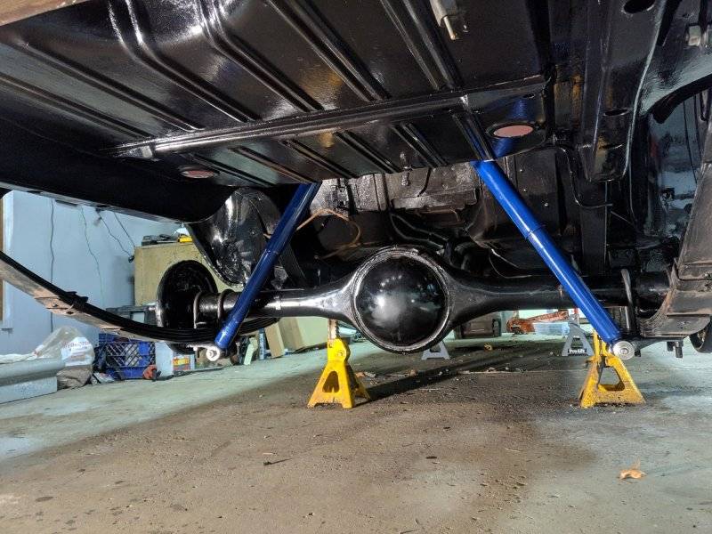

Got the rear end in last night.. not a big thing but feels good to put parts back in the car finally :)
need to paint the tunnel the gas filler tube goes in.. then the tank this weekend..

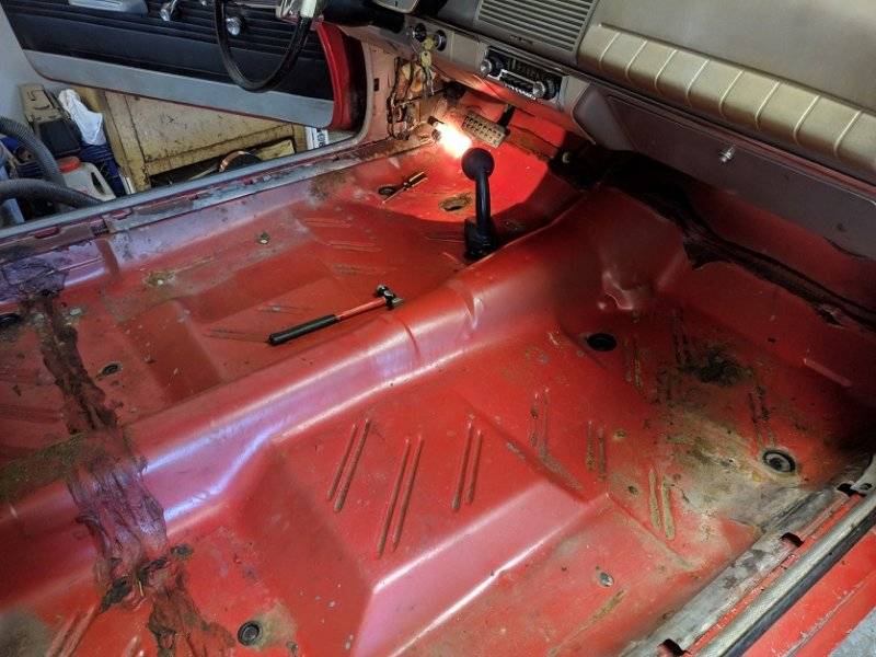

so.. motor showed up, it's a 85 not 88.. no roller cam.. but no biggy there.. spent a few hours today and got the interior out, found a few holes but nothing major, already cut out the rust and corrosealed it all. Will patch it this week sometime..
P.S. found the punchcard taped to the floor...never had a punchcard before :)
